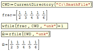

Hi Everybody,
I am trying to export (i.e., write to a text file) a vector of decimal numbers. With wfile function, I am only able to get fractional representation of data available. Is it possible to export numbers in decimal format only or should I convert them in Excel manually at the moment?
I will appreciate any other suggestion (other plugin or function) as an alternative.

You can use the "Data Exchange" plugin -> "ExportData.CSV" function

Solved. Many Thanks Sergio
If the data 'frac' is long enough, Ω will show truncated
enclose [Ω]= for full length ... [,] from matrix palette 1 row, 1 col.
