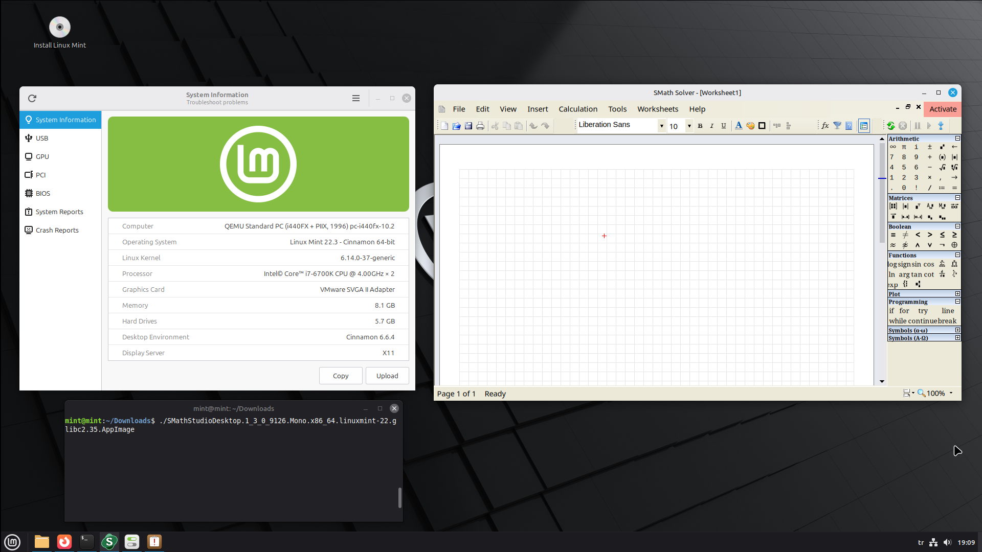

PS: I tried appimage with linuxmint_22.3-cinnamon iso on qemu, live session.
Appimage runs with no problem, I tried to run it on terminal. Then I double clicked Appimage just to try.
Everything works just fine. We can't know what is wrong unless you provide some logs.

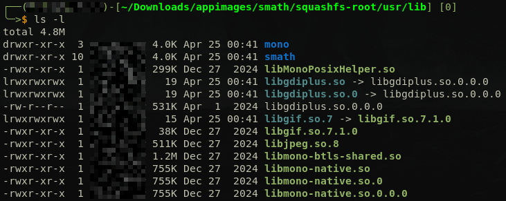

As I have already said, I can run smath appimage in a qemu linuxmint22.3-cinnamon virtual machine.
Even though appimages have libgdiplus.so file in them, somehow some computers simply ignore it.
Here is the contents of the appimage, you can see libgdiplus is already included.
Your terminal output file indicates libgdiplus file couldn't be found.
Install libgdiplus with sudo apt update && sudo apt install libgdiplus and try again to run appimage.
If this doesn't work, skip to below.
For your information, there is also a longer and guarantee to work method.
SMath is not the problem here. Mono installation of Debian based distros is the culprit.
You need to compile and install mono yourself, manually. I assure you this will work.
https://smath.com/en-US/forum/topic/QGuTDE-last/Cannot-run-in-Ubuntu-22_04#msg143067
