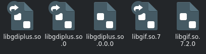

#4 Posted: 12/14/2024 7:56:54 PM
600 likes in 1,381 posts.
This happens because libgdiplus in appimage has missing symlinks.
I added and recompiled appimage with libgdiplus symlinks added.
Now it works. I don't know why Andrev didn't add those links, who knows?
Download appimage linked below, I have tried with linuxmint_22 live iso.
SMathStudioDesktop.1.2.9038-x86_64-linuxmint_22.glibc2.35.AppImage.tar.gz (11.66 MiB) downloaded 1203 time(s).

Hello.
Please, could you provide a script to create this appimage? We can integrate it into our build process and provide Mint v22 appimage package in future.
Thanks in advanced!
Best regards, Andrey Ivashov.
#8 Posted: 12/24/2024 12:36:37 AM
Hello.
Thanks in advanced!
I did extract content of original smath appimage from terminal via --appimage-extract argument.
Added libgif.so and symlinks for libgdiplus.
Mono library replacement shouldn't be necessary, only for just in case.
Andrey, you can take my appimage and extract its content.
Only smath file updates should be enough for new appimage creation.
#9 Posted: 12/24/2024 12:42:14 AM
Generally libgdiplus library is strictly depended on glibc version of system.
Usually it is creating the havoc, because of it also mono libraries too.

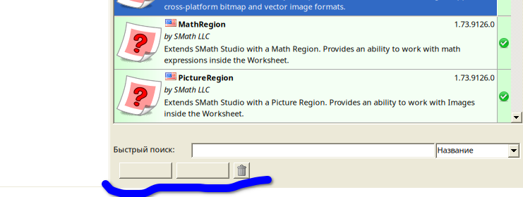

#17 Posted: 12/28/2024 1:56:55 AM
TopUser2000
TopUser2000
0 likes in 28 posts.
This should work now, please check it and report
it works even with XYplot plugin)
But some text can't be imaged like in the previous version
#18 Posted: 12/28/2024 2:15:50 AM
This version even works with ubuntu-24.04 along linuxmint-22.
I only added export MONO_WINFORMS_XIM_STYLE=disabled before exec mono.
It prevents a stupid mono bug keeping applications crash at start.
Change is applied to smath_launcher in appimage.
For the lacking of button texts, it is probably mono error.
Possibly I can't do anything about that.
