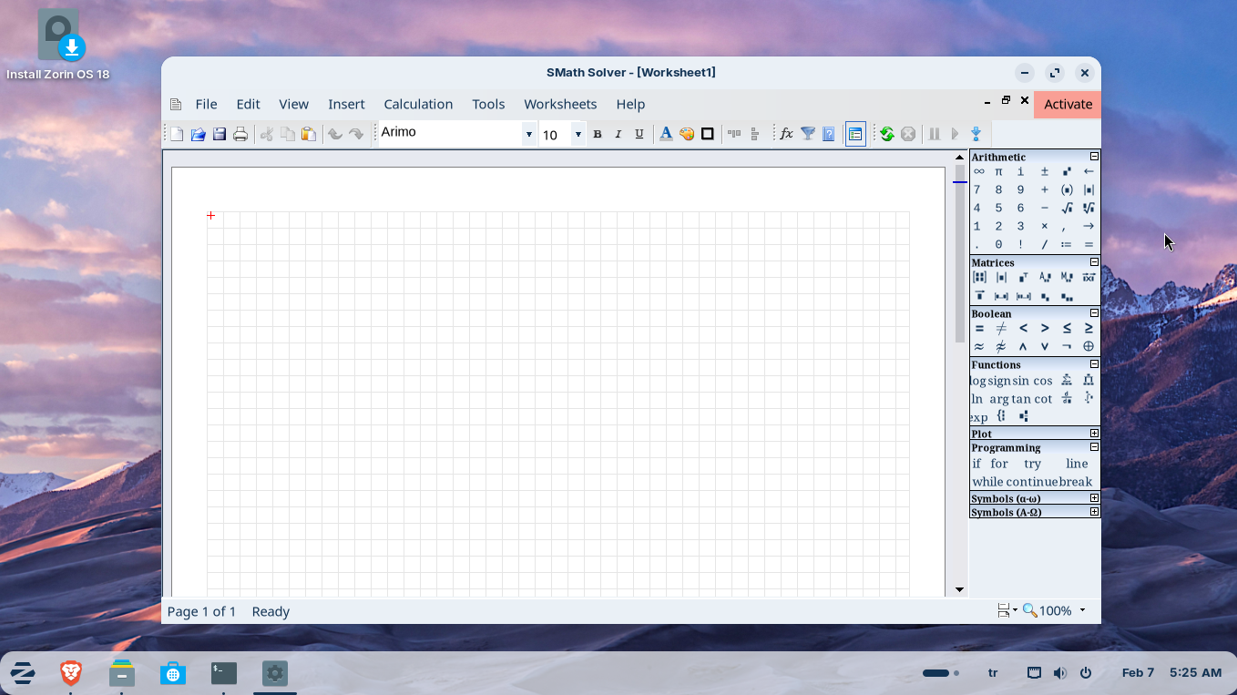

#13 Posted: 2/7/2026 5:53:19 AM
596 likes in 1,373 posts.
I could manage to make SMath work under Zorin OS.
This method should work with all Debian or Ubuntu based distros.
This proves problem is with mono installation, not SMath.
1 - I downloaded source code of latest mono from winehq, which is mono-6.14.1.tar.xz when this written.
https://dl.winehq.org/mono/sources/mono/mono-6.14.1.tar.xz
2 - I installed necessary packages to build mono from source, needed information gathered from site below.
https://www.mono-project.com/docs/compiling-mono/linux/
sudo apt-get install git autoconf libtool automake build-essential gettext cmake python3 curl
3 - I installed libgdiplus which is necessary to run SMath mono later.
sudo apt-get install libgdiplus
4 - I patched two files (mono-heapviz and w32file-unix.c) using a text editor.
--- a/mono/metadata/w32file-unix.c
+++ b/mono/metadata/w32file-unix.c
@@ -28,7 +28,6 @@
 #endif
 #ifdef __linux__
 #include <sys/ioctl.h>
-#include <linux/fs.h>
 #include <mono/utils/linux_magic.h>
 #endif
 #ifdef _AIX
--- a/scripts/mono-heapviz
+++ b/scripts/mono-heapviz
@@ -7,7 +7,7 @@
 from __future__ import print_function
 import sys, os
-import Image, ImageDraw
+from PIL import Image, ImageDraw
 from xml.sax import ContentHandler, make_parser
 from xml.sax.handler import feature_namespaces
 from optparse import OptionParser
5 - I compiled and installed mono with info from mono site.
PREFIX=/usr/local
VERSION=6.14.1
tar xvf mono-$VERSION.tar.xz
cd mono-$VERSION
lib32disabled=yes
./configure --disable-system-aot --prefix=$PREFIX
make
sudo make install
6 - I modified smathstudio_desktop_mono file so a cumbersome error is fixed.
#!/bin/sh
export MONO_WINFORMS_XIM_STYLE=disabled
exec mono "./SMathStudio_Desktop.exe" "$@"
7 - I imported certificates to mono for web and server connection.
sudo cert-sync /etc/ssl/certs/ca-certificates.crt
This is the result when I run SMath with ./smathstudio_desktop_mono
Edited 2/8/2026 9:22:59 PM
