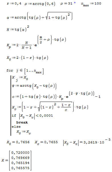

#2 Posted: 10/2/2020 2:47:52 PM
1,361 likes in 2,275 posts.
problem_Kr.sm (10.77 KiB) downloaded 1253 time(s).
hanskl 10/2/2020 7:54:00 PM

#4 Posted: 10/2/2020 4:58:52 PM
Thank you for your suggestion Martin!
I need the output X to be a function of r and rho. Is that possible?
Some random questions...
1. why do you use arctg instead of atan?
2. does the iterative process have to be wrapped into a for loop where you need to give it a range, and ultimately an upper boundry (n.max)?
0. I think you would need to wrap the full procedure into a function of r and rho with X as return value. Alternatively, you might come up with a recursive definition of the procedure.
1. It is just the setting world versus european style for functions. It is the same function, just displayed according to the GUI settings.
2. the for loop just came in handy for generating the indices for storage of iteration history. You could use while 1 as well. I also thought it was a good idea to have an upper limit for the iterations in case the algorithm might diverge.

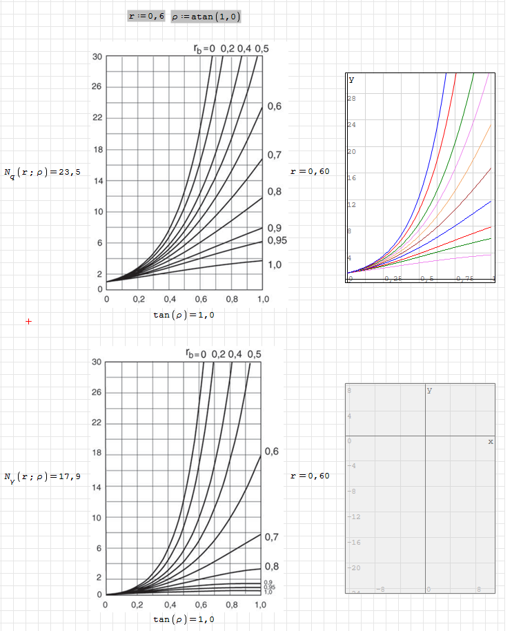

Hi Jean,
Thanks for the sample.
I think I got my calculation working now with (a lot) of help from Martin.
I cant plot N.gamma(r, rho) because it obviously takes an enormous amount of computational power.
However, the formulas seem to return the correct value when you compare to the diagrams in this sheet (the benchmark for my calculation).
PS. Is there some way to speed up the calculation of N.gamma? For some values of r and rho it can take Almost a minute to compute.
Cheers
problem_solved.sm (511.22 KiB) downloaded 1184 time(s).
#8 Posted: 10/2/2020 9:02:57 PM
Get a quick insight ... that you can mesh finer.
problem_solved More Insight.sm (517.45 KiB) downloaded 1194 time(s).

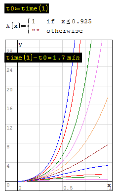

#12 Posted: 10/3/2020 2:40:12 PM
My oldere version would go on for minutes without being able to plot N.gamma.
My steam engine laptop SS 6179 runs Martin in 1.8 min.
It runs the solver 168*10= 1680 for all 10 plots
Set j=9 ... constrain gamma 0.9 reluctant
Set the solver in eval(,) mode.
problem_solved_Kr Sanity.sm (510.04 KiB) downloaded 1262 time(s).

N.γ(r,ρ) should plot in ~ 30 s on modern machines.
Saved in my Project file ... any abstract about the project ?
Project Hanski Unknown.sm (513.66 KiB) downloaded 1197 time(s).

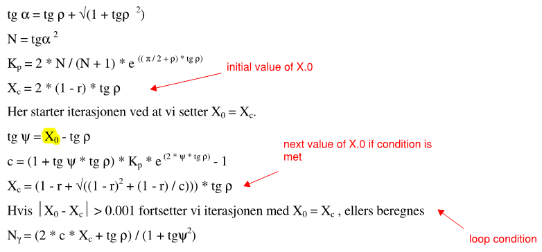

The functions calculate soil bearing capacity factors for drained conditions. N.q is used internationally, but N.gamma is according to Norwegian recommendations.
Cheers.

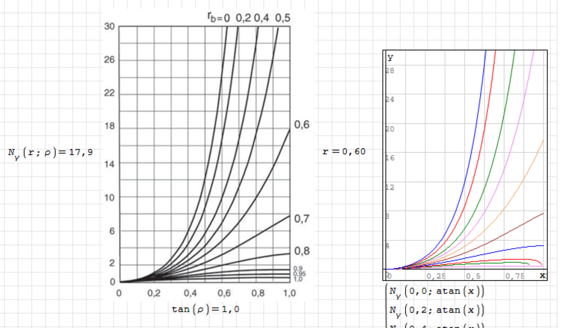

#20 Posted: 10/4/2020 1:51:31 PM
hanskl
hanskl
7 likes in 158 posts.
I have tinkered a bit because there seems to be a mismatch between my graph and the diagram for some values of r and rho.
The plots of N.γ(0.9,atan(x)) and N.γ(0.95,atan(x)) has an odd shape when they approach x=1. It turns out there are some complex solutions in this area.
Is there anything to be done about this, to make the graph closer resemble the diagram?
Cheers
