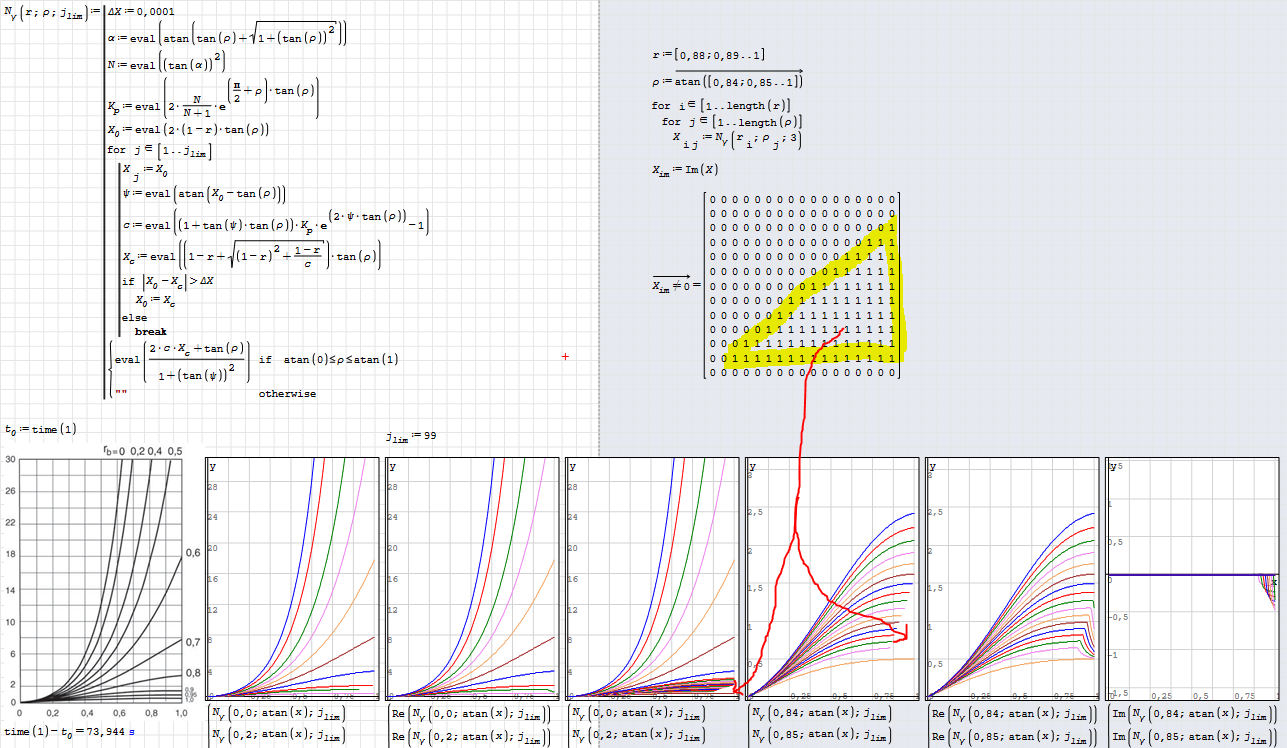

The plots of N.γ(0.9,atan(x)) and N.γ(0.95,atan(x)) has an odd shape when they approach x=1. It turns out there are some complex solutions in this area.
Is there anything to be done about this, to make the graph closer resemble the diagram?
This is a good observation, I did catch it but didn't mention.
Yes the system generates some complex values, can't track it back
in the generating algo. Will have another look.
The atan(,) from numerical libraries does not generate complex.
That's why you had no plot initially, complex blinds the Quick plot.

Another interesting observation is that j.lim in the even Numbers generates values in the areas mentiod that are far too big, while odd j.lims generate conservatively small values.

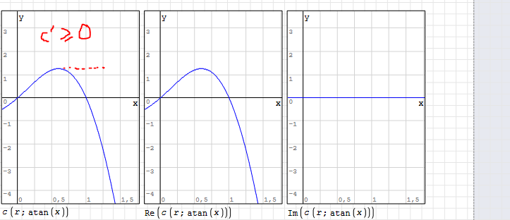

Take a look at this sheet, where every factor of the equation has been ploted separately.
It seems the complex numbers starts with X.c before the iterations start, due to c going negative.
EDIT: It seems in order to produce a plot similar to that of the diagram, dc/dx can not be allowed to be negative. How would I be able to manipulate this?
Cheers.

From your last report, you are right and wrong.
In many more projects, residuals complex have been observed
where the maths do not generate complex. The numerical Smath
engine is in cause. In other applications Smath 32 bits is too granular.
Your project is a two time constants XFR [Transfer Function],
associated wrt the composite process gain Kp. That is much different
than XFR in Process Control Techniques. Maybe the model is ill posed.
In the mean time, by pushing j 1..99 we get a much better recovery.

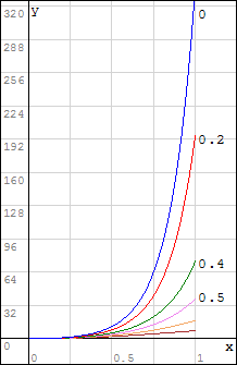

Back at it again, I am now trying to plot these functions in Zedgraph with a log scale.
I've found that "if" within the function is not supported by Zedgraph ("x is not defined") and "cases" breaks the iteration process.
Is there any way to make zedgraph plot my function?

log scale 'y' deteriorates the reality. The project is in two different plots.
Easy to add labels for the part of large deviations, like this demo.
IMHO, much better for publishing the reality. You can label part two as well.

#31 Posted: 10/25/2020 9:40:07 PM
X_Y plots reject conditional. Try to remove them in the program.
You can log scale the calculated ordinates, example attached.
Project Hanski Soil Drainage Ng.sm (321.38 KiB) downloaded 1132 time(s).

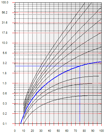

Nγ is a factor used in the following equation to calculate soil bearing capacity.
σ.v + a = N.q*(p' + a) + 0,5*N.γ*γ'*B.0
r = is roughness of the foundation surface, and ρ = internal friction angle of the soil.
https://www.geostru.eu/blog/2016/06/20/bearing-capacity-for-shallow-foundations/
Cheers.

You can create an interpolated blue track trace, read Nγ on the plot.
I'm not completely happy of the Y log, however immaterial for application.

The whole business of ploting the function is just for documentation purposes, to make sure the function is correct (compared to the referenced diagrams).
In practical application, only the function will be used.
