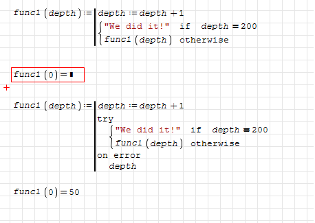

To better illustrate what I think is happening I've created the following worksheet. The first function definition is just a simple function that calls itself recursively until its 200th call at which point it exits. However, when run it experiences the same error as we see in the sudoku.sm. I rewrote the function using a try/on error and we see we only get to 50 iterations before it fails.
recursion.sm (4.13 KiB) downloaded 1077 time(s).
What I understood considering your last messages, you think there is nothing significant wrong with the code itself. Problem is SMath handling of recursions.
So, it comes forward that is why I wouldn't be able to make an SMath Sudoku Solver with recursion.

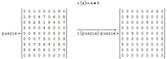

#10 Posted: 8/30/2019 7:41:02 PM
I think it's possible to fill the '0' positions of the 9x9 Sudoku
with random not common to the existing filled position.
Filling one col at time, collect ...

I remember this limitation was introduced some time ago to avoid unintentional hard crashes on wrong formed algorithms; considering that any recursive algorithm can be made iterative, you probably have to design it in another way or find a different code
