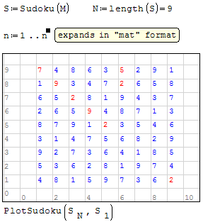

Hi. This other version stores all the intermediate steps in the brute force algorithm, but I fail trying to animate it. Hope someone else can do it.
Thanks Alvaro for that gorgeous piece of work !
The "mat" style [n:=1..9] may have other applications ?
As it looks: left over from very original Smath versions.
In many instances SS 5346 needed mat2sys conversions
