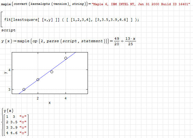

Does anyone know if this maple function works in SMATH? I cannot get it to work.
File not found.
If not available, is there another similar regression fit function available?
Sorry about that. Update to sm file.
I am really struggling. It shouldn't be this hard.
This version of Maple 6 regression fit also does not work.
Maybe someone could give me examples of the five input arguments to the SMATH Fit(5) function as noted in the figure.
File not found.

It is possible to use this function, but it is difficult. To do this, you need to include the stats package in the with.inс file. By default, not all packages are included in the plugin and you must manually specify the required ones in the plugin folder (bin\with.inc):
with(linalg):with(inttrans):with(plots):with(stats):
Unfortunately, the Maple syntax is difficult to replicate in a document, so the ability to use the symbol engine is limited. I'll see if I can somehow use this solution with vectors from the document. Now I recommend using alternative solutions, which I hope will be offered soon.

About maple, as far I know, in the version 6 the equation to fit must be linear in the unknown parameters, as it don't have the uppercase 'Fit' package, but the old 'fit' one.

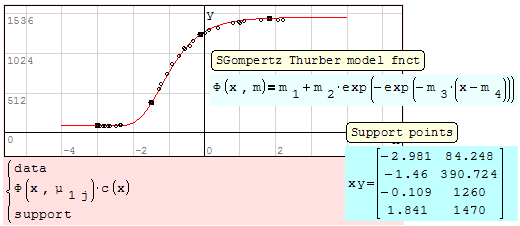

#14 Posted: 6/5/2023 6:32:31 PM
... Smath Thurber fit
Dear Uni I tried to duplicate your example after adding with(stats) to the plugin\bin\with.inc Unfortunately I seem to do something wrong. Could you assist me? Thanks in advance. I have added my attemptMapleFitTest.sm (3.75 KiB) downloaded 1329 time(s).

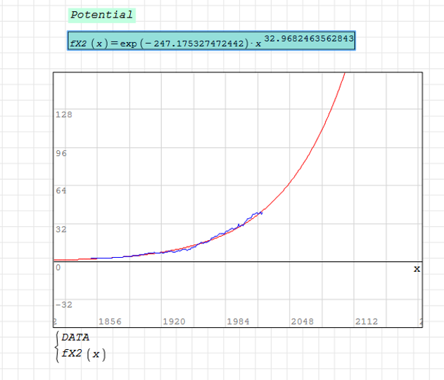

So, I have come to the conclusion that there are no built-in curve fitting routines in SMATH that will allow me to do an exponential fit like I do in Mathcad 15. ....

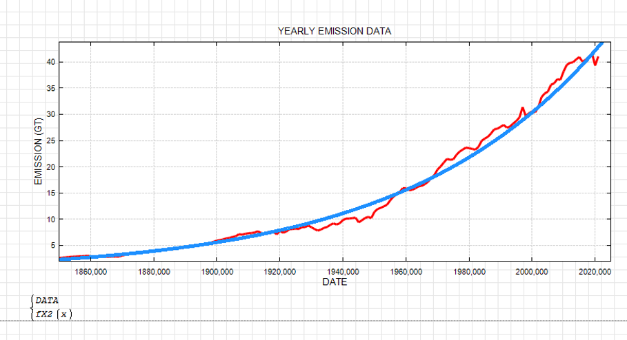

Hi Reg. The solution proposed at the post #4 in the file { CLIMATE CHANGE.sm (19.28 KiB) downloaded 1588 time(s). } only uses an standard SMath plugin, for al_nleqsolve .
Click to enlarge
I assume that means I must write my own since nothing offered so far gives a good fit like the Mathcad exponential fit. ...
In this graph, the solutions of SMath, Maxima and Mathcad are compared. SMath's solution seems as valid to me as Mathcad's.
Click to enlarge
