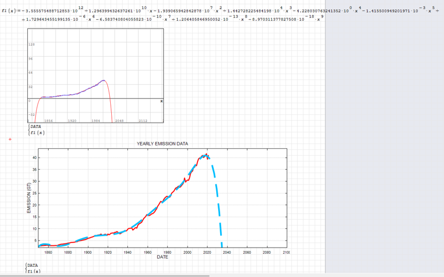

Hello
I believe that one of the best fits for the data supplied is in polynomial of degree 9,
with a correlation coefficient of 0.999254.
It seems to me that emissions cannot grow forever and that
they could remain at 2021 levels or even fall.
CLIMATE CHANGE WORKING_CBG_r4.sm (155.02 KiB) downloaded 1359 time(s).
Carlos
