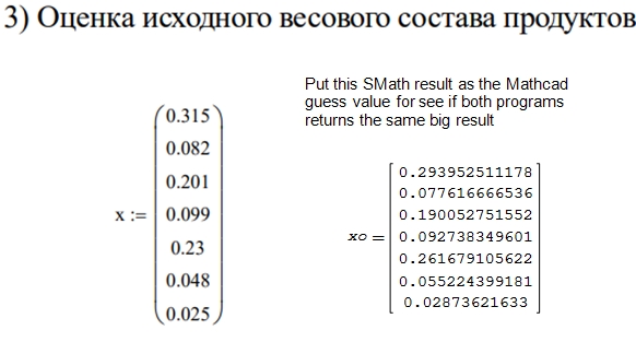

#28 Posted: 5/7/2021 1:19:13 PM
WroteIf i use this x0 in MathCad I get the same XFile not found.. x=X. I tried a lot of p values but I didnt get close result. Results are always too big.File not found.
Hi gallyon1. You are looking for a maximum. So, for your problem, bigger is better. SMath returns a bigger result, but that's not all: the results verify all the problem constraints, which make it valid answer for the problem.
Maybe I don't explain well: try to check what happen with mathcad if you use the SMath answer as the guess, this is substitute the x value in Mathcad for the xo value from SMath here:
