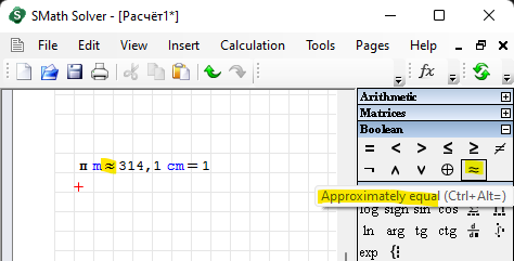

Approximately equal operator is available now (see Options dialog to set the accuracy):

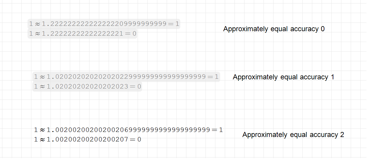

I see the "Approximately equal" operator accuracy varies from 0 to 15. What does this value actually represent?
#4 Posted: 6/20/2022 6:51:54 PM
2,343 likes in 4,056 posts.
Hi! It is an accuracy of the "Approximately equal" operator. F.e. if the accuracy is 0, then pi≈3, if 1, then pi≈3.1, if accuracy is set as 2, then pi≈3.14 etc.

considering that the "accuracy operator" parameter that regulates "approximately equal" is unique, wouldn't it be appropriate that it is defined in percentage terms?

It's more than just the decimal place precision.
approximately.sm (4.89 KiB) downloaded 1648 time(s).

Regarding that.. I think "precision operator" more appropriately reflects the intended purpose.

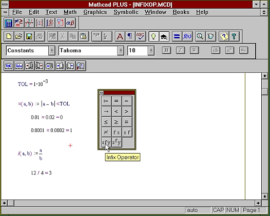

Hi. About the new approximately equal operator, another way to introduce it could be introducing a general infix operator, like in Mathcad. This screen capture is from Mathcad 6 running in Windows 3.11:
For work with units you just need to modify the rhs by abs( a-b ) < UnitsOf( a-b )*TOL (or maybe UoM). Notice that also can be a solution for another features requests, like this one about inline division: https://en.smath.com/forum/yaf_postst21614_Inline-division.aspx

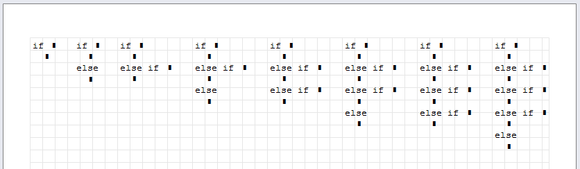

how to input else if? I use SMathStudioDesktop.1_0_8206.Mono
#12 Posted: 6/22/2022 3:30:47 AM
1,443 likes in 2,936 posts.
In the placeholders of the if() function type an "argument separator" symbol (comma or semicolon, usually)
The if without else will improve alot the readability of many scripts, thank you Andrey.

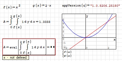

Перестали вычисляться безразмерные интегралы

Thank you. But the problem is not because of eval(). She's somewhere deeper. My f3(x) and f4(x) limits are ainterp() of the table data.
#15 Posted: 7/4/2022 5:22:02 PM
1,139 likes in 1,805 posts.
Hi. Yes, I see that there are more than one issue with the double integration, even for some simple cases it is not sowed.

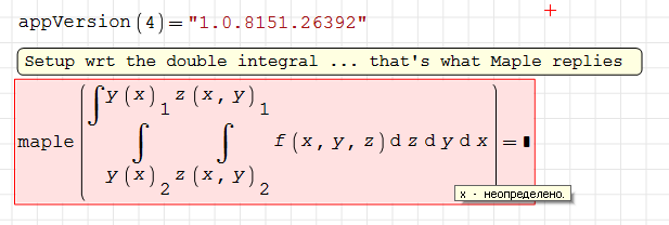

You don't provide enough maths for attempting to doctor.
You may get inspired from the double Simpson integrator.
Please, don't hesitate ... Jean
Double Integration Forum.sm (36.97 KiB) downloaded 1698 time(s).
The question is why in the stable version integrals are calculated without problems, but in the new one it gives an error in the same places?

The question is why in the stable version integrals are calculated without problems, but in the new one it gives an error in the same places ?
In other words, you declare a bug.
Designers need the document for doctoring.
... doctor since which SS version ?
1.0.8151.26932 OK
1.0.8206.25180 NFG

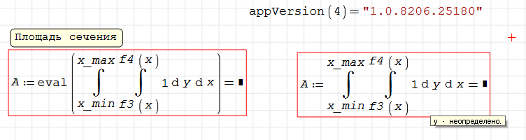

Yes, I'm reporting a bug. In version 1.0.8151.26932, dimensionless integrals with limits in the form of arbitrary functions are calculated correctly. In version 1.0.8206.25180, such integrals are not evaluated. The error "x/y - undefined" is returned.
It may be the XLS import ?
Try NOT import as a stand alone system.
It doesn't matter if there is an import from Excel or not.
