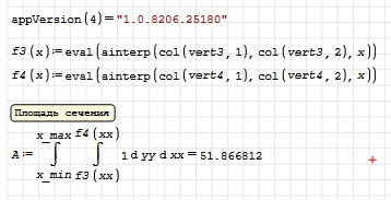

Thank you. But the problem is not because of eval(). She's somewhere deeper. My f3(x) and f4(x) limits are ainterp() of the table data.
Hi avp. Try using eval() for ainterp().
Thanks, this is how the integrals are calculated, but the function containing the integral inside still returns an error. Accordingly, the final result of the calculations still failed to be obtained.

The type errors your version reports is
wrt some limit(s) of the double integration.
Why specific to this version ?

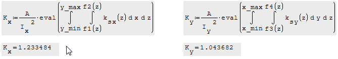

The result is not correct. The result should be Kx = 1.233, Ky = 1.044
#29 Posted: 7/8/2022 1:09:49 PM
... those values are same in my document.
You didn't report working/crap ?

Hi, Alvaro. The result is not correct. The result should be Kx = 1.233, Ky = 1.044
Hi avp. I hope the problems with double integrals can be solved, because the calculation of double integrals that SMath had was quite powerful. The only way to calculate Kx, Ky would be to discretize and integrate over the cubic splines curve.

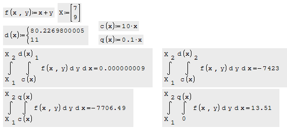

... code that test double integration in your latest SS.
Hoping more Collab will code as well to sanity.
