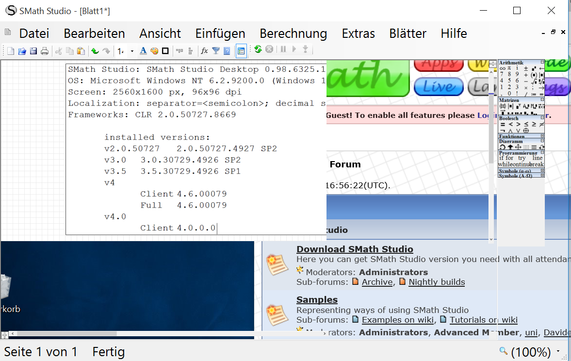

Due to wrong dpi detection, the user interface is inconsistent, the Contents of the ui Areas are too snall and don't match the actual pointer Location.
The screenshot is made on a win10 13" macbook pro with definitly not 96dpi.
#4 Posted: 4/28/2017 1:00:09 PM
1,443 likes in 2,936 posts.
I guess you have to remove image region plugin.
#5 Posted: 4/28/2017 1:21:32 PM
karlashnikov
karlashnikov
1 likes in 2 posts.
Thank you, that's it!

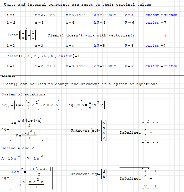

Clear() doesn't work with vectorize(), whereas IsDefined() does.
It is not really essential to have that feature but the response indicates successful execution, which is wrong.
Clear.sm (29.29 KiB) downloaded 1773 time(s).
