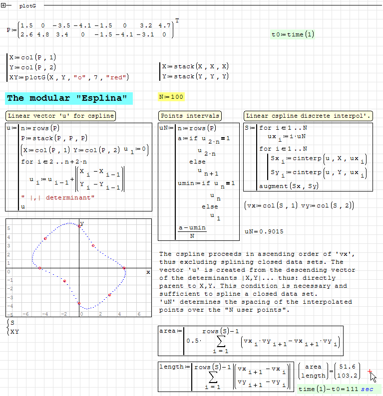

#1 Posted: 9/12/2016 2:36:46 PM
This one works well for the given data set. Mesh finer at will and if needed,
bilinear ... not much use for bilinear, whereas "spline" is just something.
Spline Esplina [AI2000].sm (23.66 KiB) downloaded 1189 time(s).
#2 Posted: 9/12/2016 7:08:01 PM
... a faster version: one twin col extractor removed.
By same token, I wonder why the col extractor col(,,) is so slow ?
Spline Esplina [AI2000].sm (23.75 KiB) downloaded 1212 time(s).

#4 Posted: 9/12/2016 11:07:59 PM
Thanks Ber7 for "speedy Gonzalez". In fact, the "uN"
conditional code is redundant in this dataset.
Here is the latest version, even faster.
Spline Esplina [AI2000].sm (23.66 KiB) downloaded 1235 time(s).

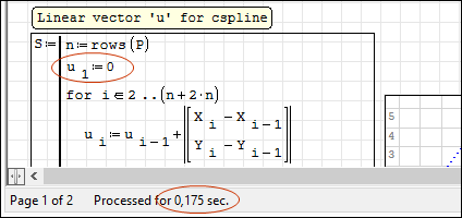

#8 Posted: 9/13/2016 12:08:37 PM
WroteYou forgot to specify first element of u vector.
By doing so you can speed up calculation even more:
Thanks Andrey, damned me !
While you are there, can you speed up "DeBoor" ?
Spline De Boor [Esplina].sm (47.76 KiB) downloaded 1191 time(s).
#9 Posted: 9/13/2016 12:47:49 PM
Done
Spline De Boor [Esplina]_mod.sm (47.37 KiB) downloaded 1272 time(s).
Timings:
Regards.
Timings:
- 6.1 seconds by 0.97.5890
- 2.3 seconds by 0.98.6096
Regards.
#10 Posted: 9/13/2016 3:32:56 PM
Thanks Andrey,
... for the local definition of Sx(v), Sy(v).
Must be consistant with all upward local definitions.
#11 Posted: 9/13/2016 3:53:06 PM
#12 Posted: 9/14/2016 12:51:51 AM
Quite right Andrey: 'u' is 'm', which 'm' is redundant.
I must have constructed N_(v,j) aroud 'u' from some source,
thus easier to check the coding. The attached work sheet
has been refactored with auxilliary explanations.
Can be used as model for DeBoor, pretty easy to adapt to
any project. Spline order is linear interpolation around
the polygon. Spline order 2 is "convex hull" per say.
They are about the only two types splines useful for
technical works [?]
Spline De Boor [Loop].sm (41.68 KiB) downloaded 1240 time(s).
