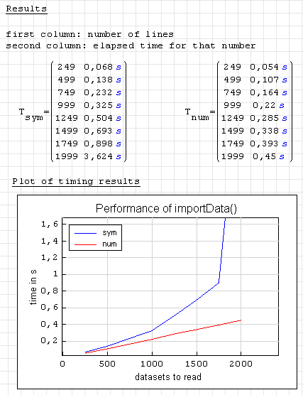

Thanks for the tips. The tips reduced the load/calculate times tremendously and now may be useful to me.
Edit:
So I just came across the snippets feature. I never knew this even existed sadly.
