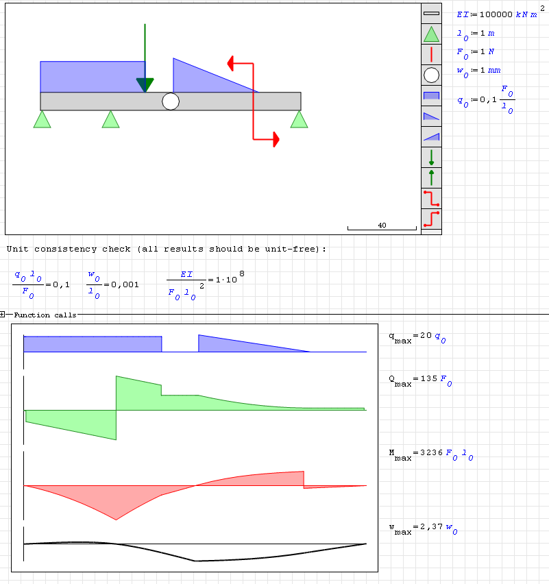

BeamFEA updated:
Unit support was non-trivial. I failed to make the solver unit-proof because matrix inversion with units is not robust in SMath (probably due to poor pivot scaling in the algorithm).
Also, you easily can create programs which will crash SMath immediately after opening them (if auto-recalculate is on). I added this to SS-1227.
- unit support. You can specify units as factors for the modeler units. The preprocessor eliminates the units such that the solver input is unit-free. In the output the appropriate units are applied and can be modified as usual for display. Note that you can define separate units for length ('l.0)and displacement ('w.0).
- separate diagrams for distributed load, transverse force, bending moment and displacement
- input color scheme changed:
- concentrated moment load and rotational constraint in red
- concentrated forces and vertical supports in green

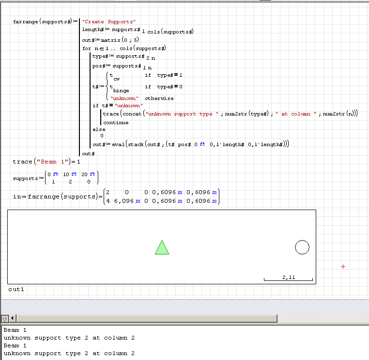

#68 Posted: 1/25/2015 7:51:10 AM
RFreund, sorry for not being responsive lately. Quite busy at the moment.
I think for the supports you succeeded to implement the translation function from your favorite input format to modeler output. I just made some modifications:
- better readibility by introduction of temporary variables and by replacing nested ifs by cases()
- better robustness by creating valid modeler input even in case of unknown support type. In that case, a detailed error message is written to the output window via trace(). This is essential, as the input selection in the modeler gets lost whenever the input renders invalid. This is annoying, because you have to re-select the pre-defined layout in the modeler again.

#70 Posted: 1/25/2015 11:57:59 AM
Martin,
Again thank you for the response. Attached is an updated version, probably with poor scripting again by myself (side question, is "scripting" the correct term to use here?).
So a few questions/comments:
Thanks again! I think once I have a figured this out I will have an efficient beam calculator and I can start posting more analysis / design examples/snippets.
Modeller input.sm (82.27 KiB) downloaded 1521 time(s).
- Could you elaborate on cases()? When I type in cases its description is "Define piecewise functions"
- Also (maybe this is cases) but how did you create the system using if and otherwise?
- I'm not sure the best/simplest way to handle the scaling of the beam and loads. If I understand correctly, the beam height from the modeler is given to the preproccesor and used for EI. Likewise the height of the loads are used to determine magnitude in the preprocessor. Therefore it would seem that I need to relate the scaling of the beam to the E and I input and the loads to the load input. However I think that maybe it would be more 'robust' if the scaling was separate from the loading input. That way you can change the scaling to proportion things as you'd like. Or mabye all items should be in proportion to the length of the beam. Maybe this is wrong though. In any case, I think that direct input into the preprocessor would be too challenging for me or creating unnecessary work and my main objective is to have a functioning script and maybe we can modify later. I'm looking for input on what you think is the best approach.
- Another issue is Varying loads that are trapezoidal in shape. Really I need to send the w.p# input to a script which checks for this condition and creates a new matrix with a partial uniform load a triangular load over the same length of beam. In the attached a put a small section of script showing my intent.
