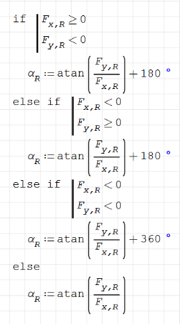

#23 Posted: 6/15/2023 9:21:49 AM
Owner of post asked for y/x, not x/y.
IF X & Y is positive solve:
a°=atan(x/y)
IF X is positive and Y is negative solve:
a°=atan(x/y)+180°
IF X is negative and Y is positive solve:
a°=atan(x/y)+180°
IF X & Y is negative solve:
a°=atan(x/y)+360°

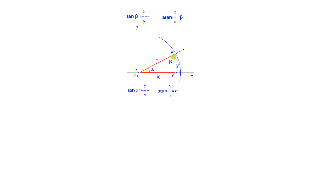

From the first post:
From the big picture in the post #6:
And form the physical context, where is trying to decompose a plane Force into its horizontal and vertical components, it's obvious that those are the correct formulas, and not the ones "handwrites" in the post #3. For this is because one choose a wysiwyg live math editor like SMath and not a death plane text like octave for make engineering calculations.
