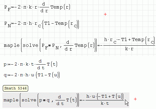

Maple Wrapper plugin can help with some symbolic problems.

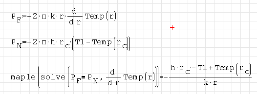

Hello Uni,
Which one is right, which is wrong ?
Personally: I would scrap Smath from subscripted variable.

All answers are correct. I just have invisible braces. If you click on the expression, then they appear. I don't know why it happened.
#25 Posted: 3/2/2016 10:43:40 PM
I trust you Uni, because I know you tell the truth.
But an an algebraic result to be copied as such, wrong.
Maple does not like subsrcipt. That by clicking it shows
the brackets, to me it is a bug that it does not
output the right result.
I accept the subscript as a local tutorial demo.
For real work and particularly for publishing: NO subscript.
Cheers, Jean
Don't worry about subscripts. For the variables subscripts supported as was described here.
If Maple Wrapper meet a variable with the dot (comma) in its name this name will wrapped with the symbol `. You can see this in log file (\mvr5\mvr5.txt).
The log for int(x.1,x.1):
03.03.2016 9:20:29 [->] smath_int(`x.1`,`x.1`)
03.03.2016 9:20:29 [->] C:\Temp\tmpAC26.tmp:
interface(quiet=true);
with(linalg):with(inttrans):with(plots):
writeto("C:\\Temp\\tmpAC27.tmp":
smath_line := proc() local i: for i from 1 to nargs - 2 do args[i]; od: end:

03.03.2016 9:20:29 [<-] C:\Temp\tmpAC27.tmp:
1/2*`x.1`^2
03.03.2016 9:20:29 [<-] 1/2*x.1^2

Why the 1rst display was wrong?
I don't know. May be Andrey will see this and make some comments.

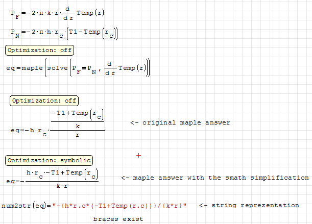

Thank you for figuring it out!
Issue was in Math Region. It is fixed now. Fix will be available in new SMath Studio build.
