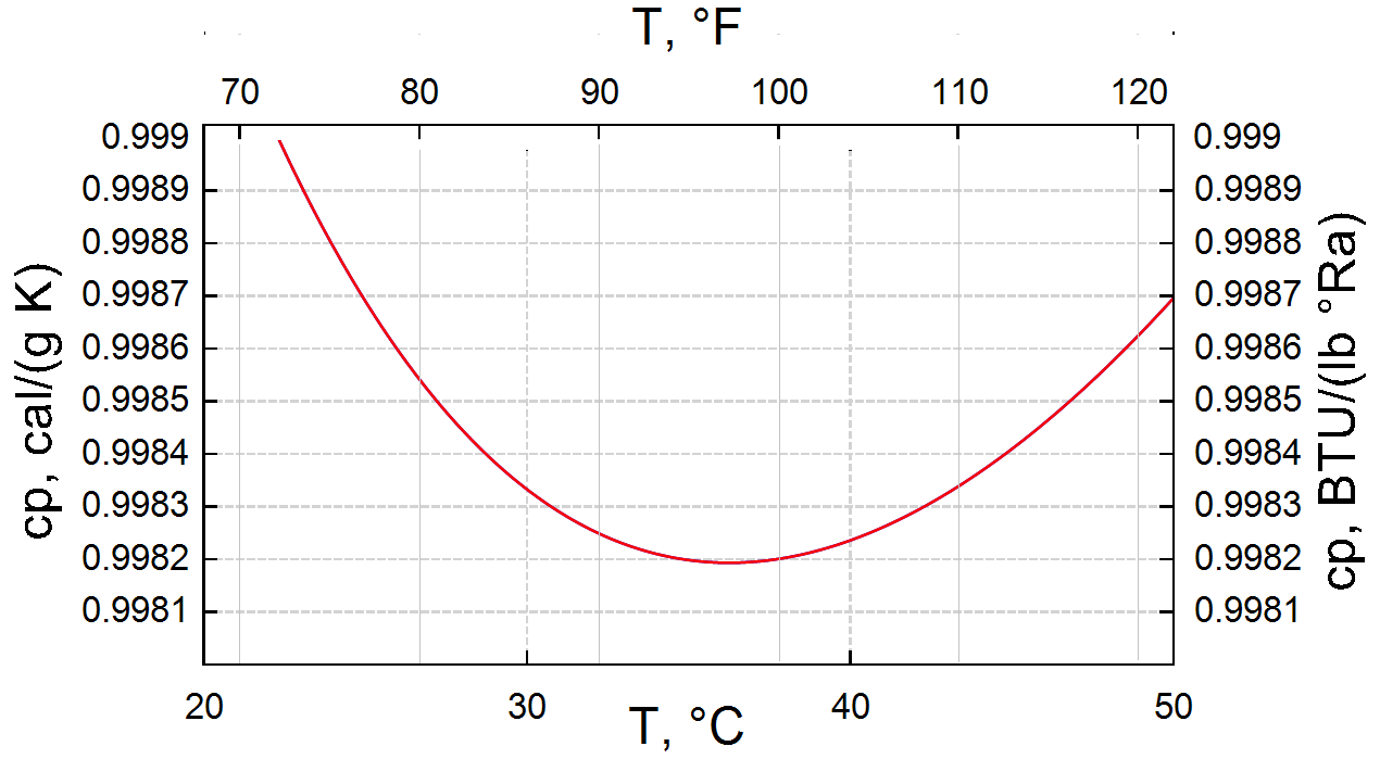

It will be good to have in SMath
2X-2Y.sm (12.9 KiB) downloaded 1809 time(s).

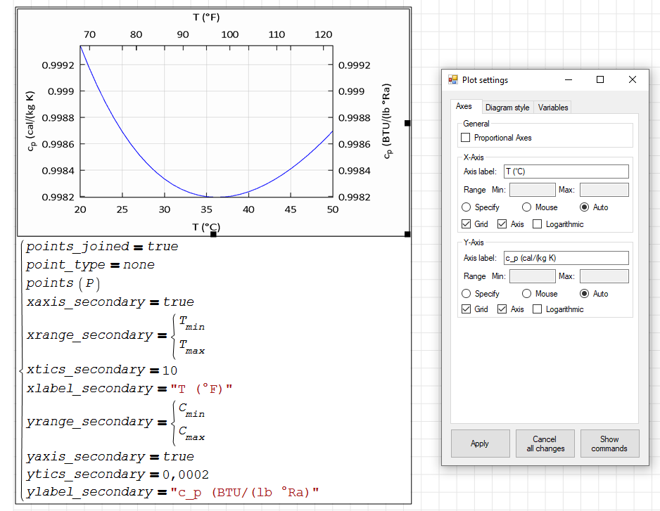

If you let in Maxima, then you can have it.
2X-2Y_Kr.sm (169.77 KiB) downloaded 1738 time(s).
