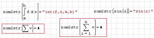

num2str() fails to convert a sum to a string. In the sum(1) example "syntax is incorrect", in the sum(4) example "n is not defined".

I confirm and add some further example.
[albumimg]284[/albumimg]

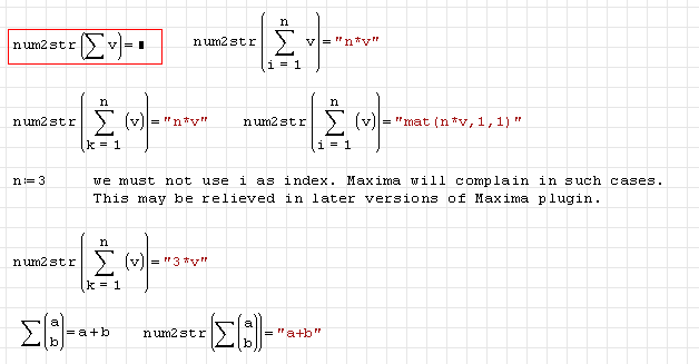

This is the current state. sum() now can produce symbolic results.
num2str() should provide a string corresponding to the unevaluated expression if it cannot be evaluated.
