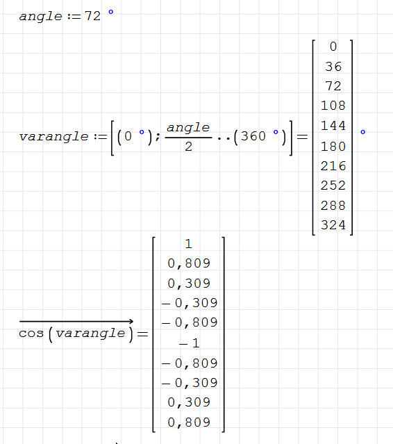

I'm trying to convert some old Mathcad files into SMath but am stuck with what must be an elementary problem, I've looked at various tutorials but can't find a solution, no doubt due to my own incompetence.
I am defining the following variables: angle:=72 and varangle:= 0, angle/2..360
In Mathcad if I then define: test(varangle):= cos(varangle) the output of test(varangle) displays correctly in a column.
If I try the same in SMath I receive either an 'argument must be scalar' or 'fill in all empty elements' error.
Thanks for any advice.
Screenshots of Mathcad and SMath attached.
btw, great software.
Mathcad - output.pdf (26.44 KiB) downloaded 995 time(s).

#7 Posted: 9/28/2024 4:09:41 PM
127 likes in 342 posts.
now you can use the "vectorize" function, which you also find in the side panel, and perform the trigonometric function element by element.

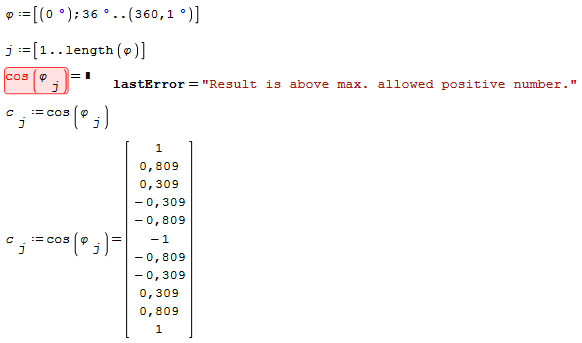

#8 Posted: 9/29/2024 10:22:50 PM
1,361 likes in 2,275 posts.
An alternative to the vectorize() function is the use of index vectors.
They, however, only work if they are used in a definition.
Worksheet1.sm (5.28 KiB) downloaded 1640 time(s).
