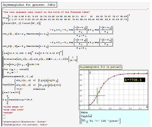

Here it is.
losa-forum.sm (862.11 KiB) downloaded 1920 time(s).

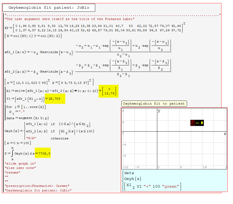

Sorry Jean but i don't understand what i'm supposed to see. I also get "data - not defined".
#82 Posted: 1/17/2023 10:18:15 AM
Sorry Jean but I don't understand what I'm supposed to see. I also get "data - not defined".
data not defined probably indicates some plugins not installed.
Maybe other problems wrt your version.
#83 Posted: 1/17/2023 10:55:42 AM
Here it is.
Document does not open ... incorrect format

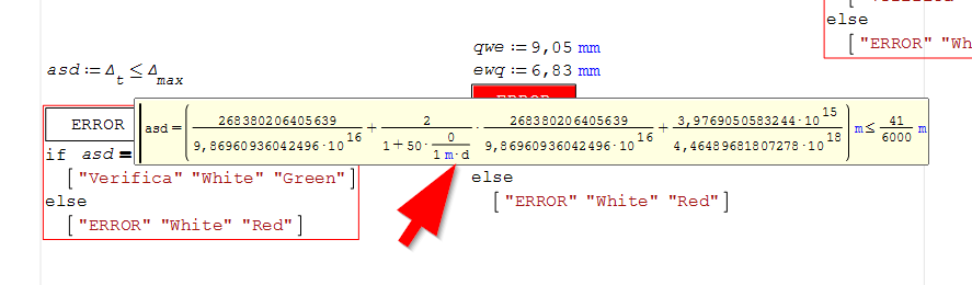

#85 Posted: 1/17/2023 11:20:05 AM
1,443 likes in 2,936 posts.
If you hover over the asd definition you can see that there is an unsolved "d" dependancy that triggers the error.
The same happens if you try to force a numerical evaluation using eval()
That is it!
As allways thanks!!
But still don't understand why Jean files fails.

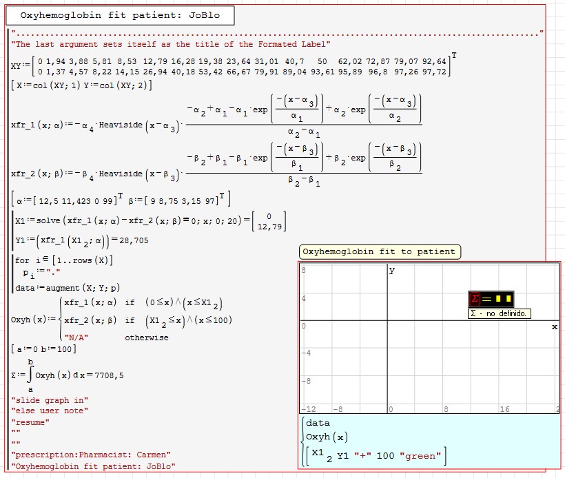

#87 Posted: 1/17/2023 12:12:05 PM
SMath Studio Desktop 64-bit
Version: 1.0(build: 8348)
Date: 9/11/2022
Slide left the Formatted Label
Side right the graph, remove the Σ no definido
You should see the plot.
#88 Posted: 1/17/2023 12:15:52 PM
That is it!
As allways thanks!!
You're welcome!
There is an excel data import at the begin of the file, is not related to the issue however so it doesn't matter. nevermind I was looking at your file.
If you remove the 3 inline evaluations it will work.
2023-01-17 16_28_05-SMath Solver - [Image Formated LABEL [Oxyhemoglobin] FORUM.sm].png
#89 Posted: 1/17/2023 12:39:57 PM
German
German
0 likes in 8 posts.
My file can be an example of things NOT to do.

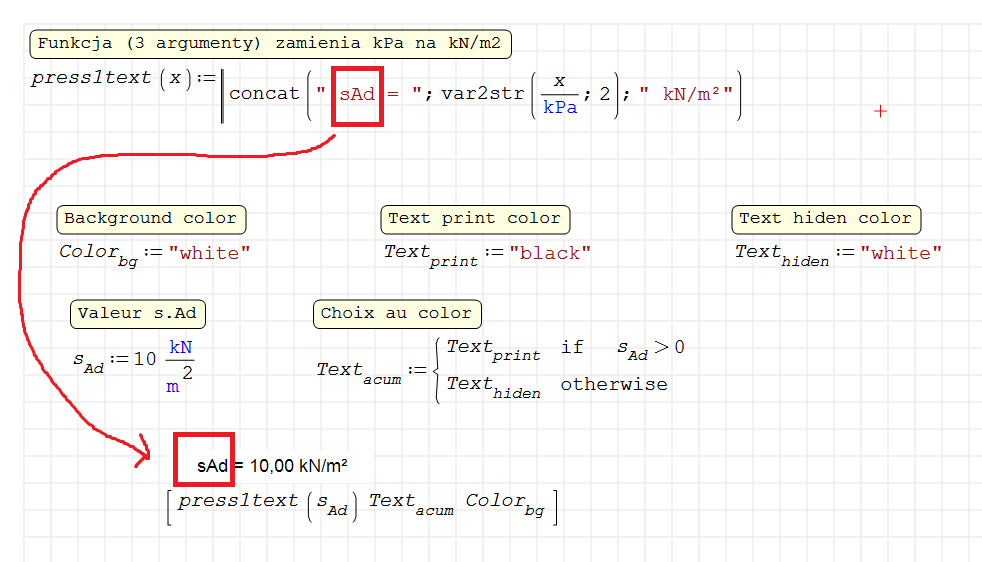

#90 Posted: 10/14/2023 11:08:58 PM
Rogalski
Rogalski
0 likes in 7 posts.
Can we manage the units that are displayed?
I have a load in kN/m2 and the result appears as kg/(m*s2).
The idea is to present only positive values (with the appropriate unit).
kind regards
Conditionally Formatted Labels_unity.sm (5.47 KiB) downloaded 1880 time(s).

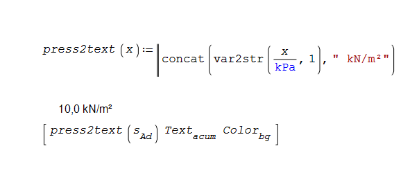

#91 Posted: 10/14/2023 11:52:58 PM
The easier way might be something like this
2023-10-14 18_53_23-SMath Solver - [Conditionally Formatted Labels_unity.sm_].png
press2text(x):line(concat(var2str(x/'kPa,1),"\0020\kN\002F\m\00B2\",1,1)

#92 Posted: 10/15/2023 12:08:06 AM
Rogalski
Rogalski
0 likes in 7 posts.
Thank you very much.
This is exactly what I needed.
