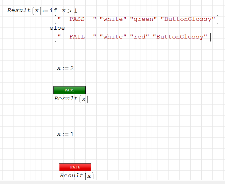

I've really been getting some good use out of this plugin for pass/fail warnings on calcs, but here's a question. I tried using a check mark and X in an if statement in the label, and it displayed correctly in the if statement but not in the result. This was using the Segoe UI Symbol font. First I'd copied and pasted from Windows Character Map and the output was just the unicode number for that symbol. I went to Settings and changed the font to Segoe UI Symbol to see if that would help but it didn't. Is this something that is possible? Thanks!

Thank you Jason, I think that I've missed to implement it in some branch of the code, I'll fix it ASAP.
Just released a fix, it should works now.

#71 Posted: 10/15/2020 3:53:42 PM
Jason McCool
Jason McCool
9 likes in 78 posts.
Works great now - Thanks!

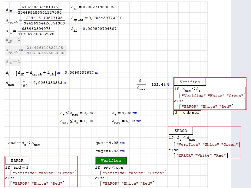

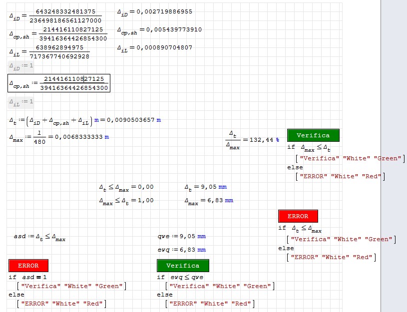

Hello, i am having problems with this plugin or i dont exactly kown if the problem is the plugin.
I attach images that can explain the situation better than my words.
When i define the same value manually the warning disappears

Hello. Better if you post the sm file, for anybody to check.

Hello, I am having problems with this plugin or I don't exactly know if the problem is the plugin.
Formatted Label supports conditional, providing set correctly.
