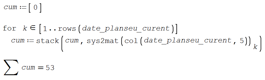

#2 Posted: 10/15/2023 5:33:50 PM
It's necessary convert each system of your 5th column to a matrix by sys2mat() function, then you can stack each matrix from 5th column and do the summation:
sumcomplexcolumn SOLVED.sm (12.77 KiB) downloaded 1102 time(s).
Oscar

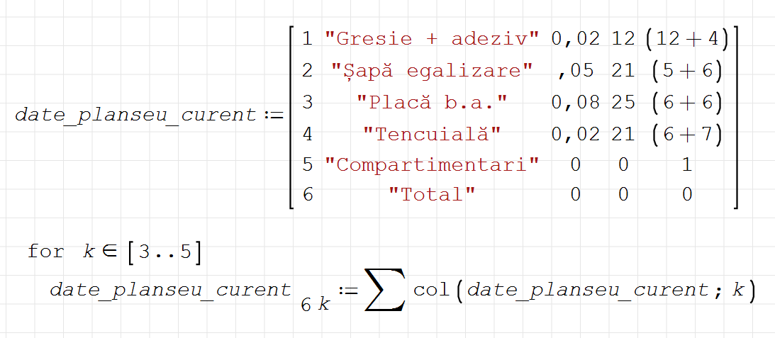

#3 Posted: 10/15/2023 6:01:59 PM
Hi Sergio,
Of course, Oscar’s proposal is a very interesting one
May I make a simple suggestion: avoid the use of “sys” data and replace it with a simple sum, as in my appended file.
Best Regards,
Ioan
If the column's sums are aasked, here is a solution for keeping the answer inside the box...:d
Best Regards,
Ioan

#4 Posted: 10/15/2023 6:09:35 PM
WroteHi Sergio,
Best Regards,
Ioan
sumcomplexcolumn (1).sm (11.7 KiB) downloaded 1128 time(s).
Nice!, you think out of the box :d
