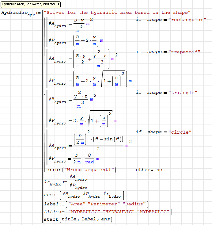

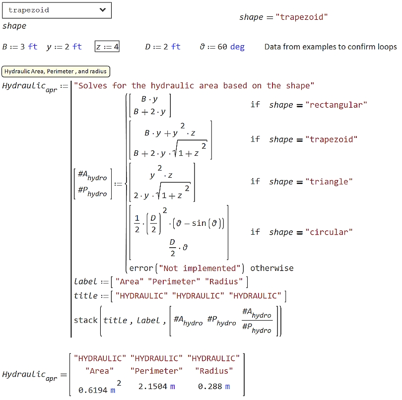

I have two forms of the program in this file. I would be happy
  • Get the program to work
In the file is a snippet of the MathCAD program I was using to confirm the structure

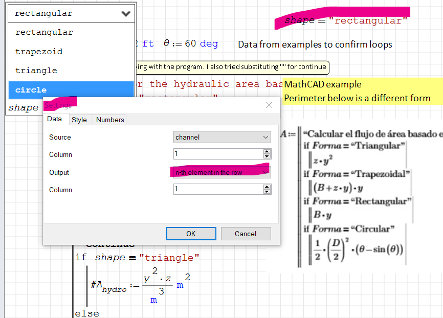

Thanks for the attachment. I remember a similar MathCAD file
It bothers me that you cannot open my 0.99.7610 SM files ...

IMHO, you may have one or more AV systems active.
No other Collabs reported "incorrect format" ???
In the circular, θ is unknown.
You may find something from Valery Goat radius .
Maths Goat Radius.sm (168.49 KiB) downloaded 1115 time(s).

I do have a θ per the screenshot above. Issue is in program structure.
Thank you for looking at this.
#6 Posted: 1/28/2021 10:30:56 PM
churichuro
churichuro
29 likes in 79 posts.

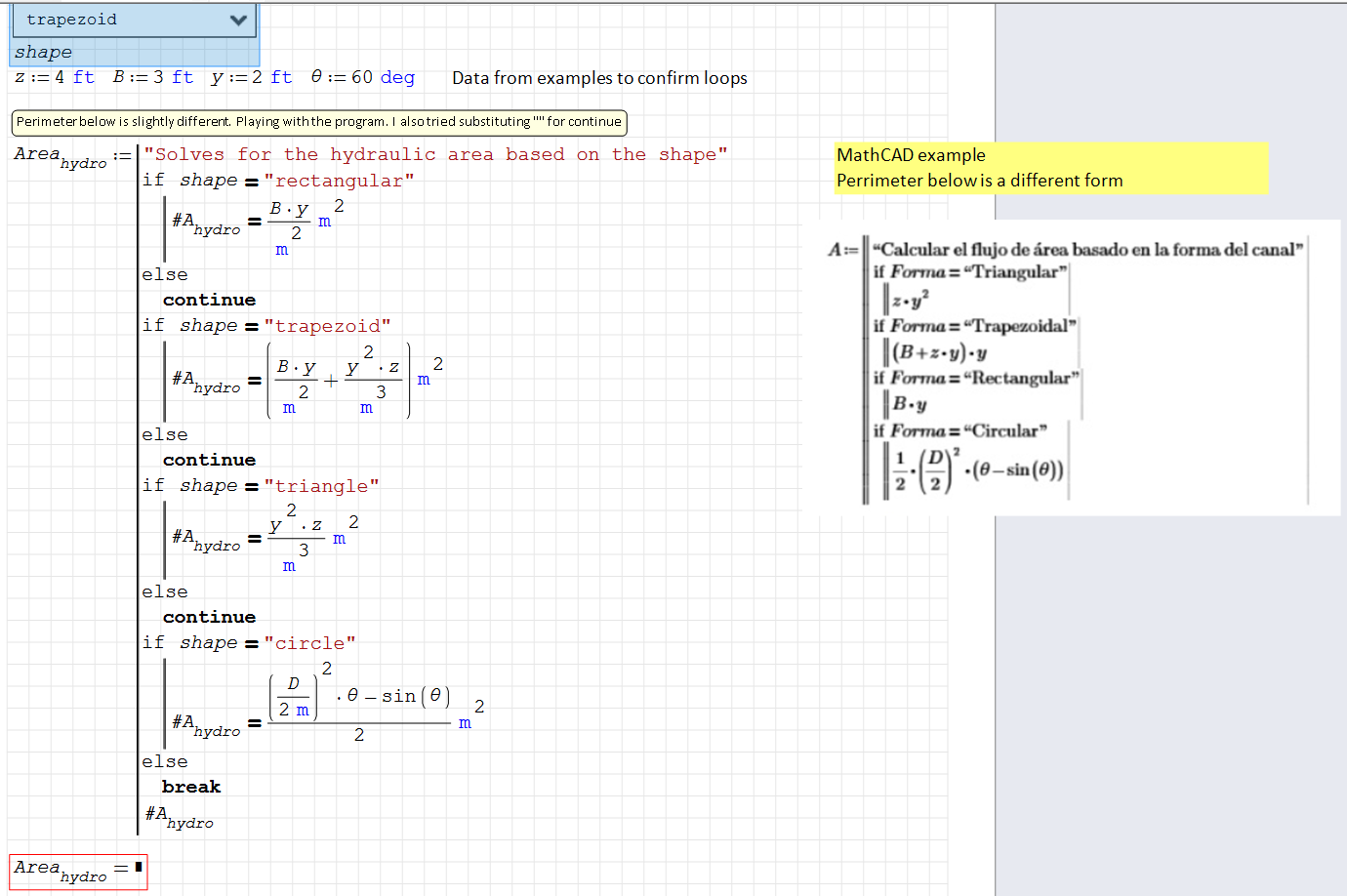

hydraulic radius.sm (215.2 KiB) downloaded 1044 time(s).
you have 2 little mistakes
shape must be a string and you are passing it an integer
and second I think that in the functions you should use the assignment (: =)
and not the symbol (=)
Interesting.
I was playing with the equation definition ":=" in lieu of "="
I also have what appears to be the correct output from the DropBox list ... apparently not a string? ... your index DOES work

#8 Posted: 1/28/2021 11:05:13 PM
Ruben Sidranski
Ruben Sidranski
17 likes in 465 posts.
@churichurro
I didn't notice that you deleted "continue" in the else part of my file. That was the issue!
"ELSE" needs to start the next "IF" loop, therefore it's nested. I'll clean it up and re-post

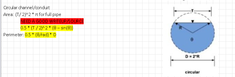

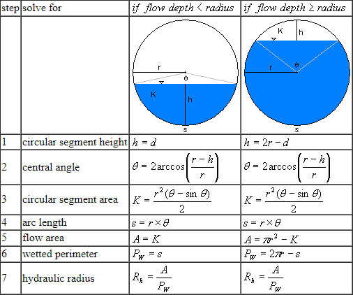

Anyone have a good description, write-up, or weblink that derives these two formulas? (Not Wikipedia)
As promised above.
This made Manning so much easier. Thank you all
Hydraulic Radius Final.sm (16.32 KiB) downloaded 1035 time(s).

Thats's nearly a prime example for using cases instead of if/else:
#11 Posted: 1/29/2021 7:01:12 AM
1,123 likes in 1,795 posts.

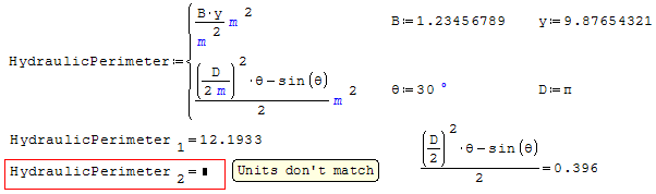

Hi. You don't need to divide by the units in the body of the procedure. Notice that z is the side slope, so it's dimensionless, equal to length / length, even eventually can have units, like mm/m. This is, given that z is the horizontal change per unit vertical change, it's usual to use one unit for horizontal change but another to the vertical change.

Anyone have a good description, write-up, or web link that derives these two formulas? (Not Wikipedia)
Wikipedia has turned about useless in too many search !
Visit this site + calculator.
https://www.ajdesigner.com/phphydraulicradius/hydraulic_radius_equation_pipe.php

... BTW, perimeter of the rectangular, triangular, trapezoidal
easy from the polygon maths, somewhere in Samples, easy to renew
from my file. Please let us know.
For the partially filled circular, there is no escape from the Segment.
The only measurable is the height of the segment.

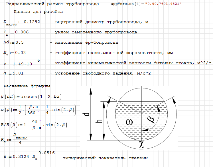

#14 Posted: 1/29/2021 9:50:18 AM
1,554 likes in 1,864 posts.
Some time ago I made similar calculations.
Hydraulic calculation (rus).sm (42.41 KiB) downloaded 1123 time(s).
I've never heard of or used "cases"
Update, to add "IFs", Jean answered the question: click right hand most place holder, coma twice for one more if... again coma twice like before. Will be dissecting this function. Thanks to others who posted sheets.
Yep. Here with correct units:
Hydraulic Radius Final.sm (15.64 KiB) downloaded 1058 time(s).
Alvaro,
I tend to use units wherever and whenever possible. I see what you mean with "z". This IS unitless, thank you for correcting this. I fixed the formula to omit units on my sheet.
I now see the units comment clearly
