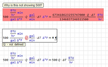

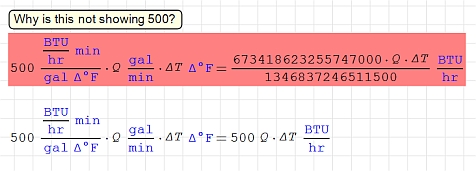

Good evening,
Looking for suggestions to better improve the maths. I am working on the write up on the side on another Sheet.
I'm having an issue in when it comes to eliminating units, better yet, proving units cancel out. Suggestions on how to better derive and show the process is appreciated.

Hi. SMath convert all numbers to it rational approximation in symbolic outputs. Maybe you can use this trick: put Q*ΔT in units and use numeric evaluation:

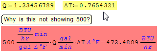

Help with the highlighted please. How do I put the variables into Units? File is updated on my laptop to numeric evaluation.

The error message reads yellow not defined

And ALVARO had a way around it where his SNIPPET/PICTURE shows what I want
HVAC Constants.sm (62.47 KiB) downloaded 1205 time(s).
Hi. Just write them: " Q*ΔT*'BTU/'hr " in the unit's placeholder.
I attach the file too.
Got it. You force the solution (=) side to keep Q and ΔT as variables. I think I tried everything BUT that!
Revised file HVAC Constants.sm (62.98 KiB) downloaded 1156 time(s).
