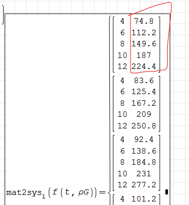

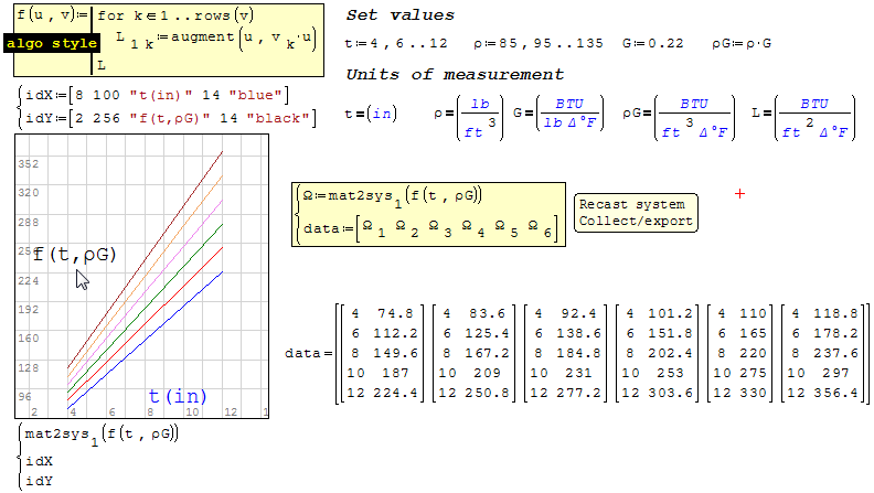

Ber7,
Still off by a factor of units (12 to convert inches to ft). I split this to a NEW TOPIC. I've never used the Mat2System function.

#25 Posted: 1/22/2021 11:49:28 AM
Ruben Sidranski
Ruben Sidranski
17 likes in 465 posts.
Thanks Ber7, nice sterilized units
But it's wrong
#26 Posted: 1/22/2021 12:05:10 PM
But it's wrong
Just divide something by 12
#27 Posted: 1/22/2021 12:08:24 PM
Ruben Sidranski
Ruben Sidranski
That's the problem. Units are important and impact the way the function is not working. Divide t by 12 and the The x column no longer starts with 4, but 1/3 and the y column is correct. Leave it as is and the x column is correct and the y column is wrong.

In dimension Ro there is a ft. Therefore, the size t
should be expressed in ft. The bug has been fixed.
Heate in-ft.sm (9.77 KiB) downloaded 1218 time(s).
Correct, divide by 12 ... in this case.
This elegant function appears to work on all empirical equations, as long as the user input units are double checks for consistent cancellation.
Is the descriptor of the function accurate? Heat Capacity Function_Sys2Mat Ber7.sm (15.07 KiB) downloaded 1699 time(s).
