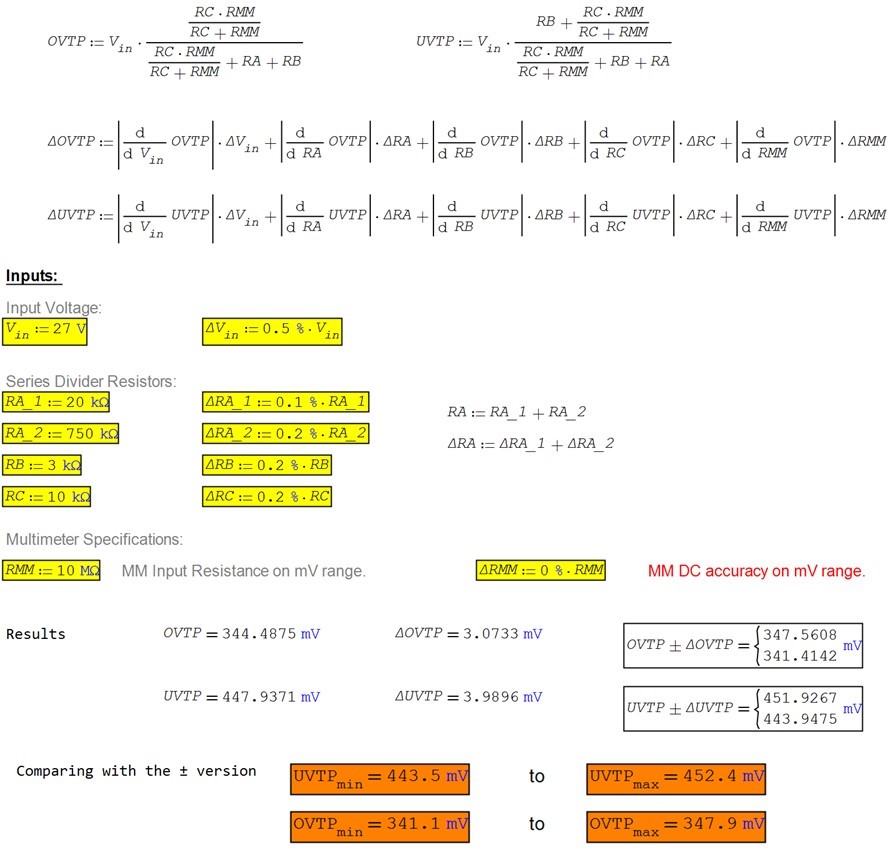

#25 Posted: 3/31/2022 6:59:02 PM
⚜ Kenny Lemens, P.E. ᵂᴵ

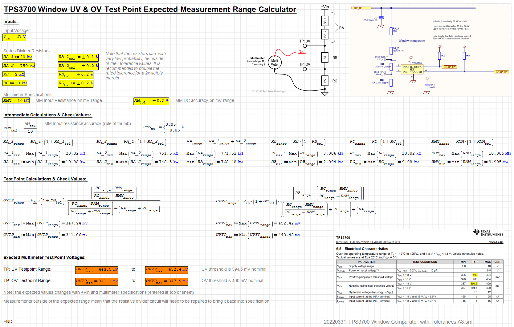

I've now converted to Davide's plugin as it really helps easy understanding, peer reviews, etc:
20220331 TPS3700 Window Comparator Test Points with Tolerances A3.sm (233.5 KiB) downloaded 1563 time(s).

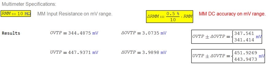

#27 Posted: 4/1/2022 2:49:44 AM
1,139 likes in 1,805 posts.
Hi. This version uses the gradient to propagate uncertainties. Although it is not clear to me what the uncertainty of RMM is, more or less the same results are obtained.
20220331 TPS3700 Window Comparator Test Points with Tolerances A3 another ver.sm (228.8 KiB) downloaded 1550 time(s).
#28 Posted: 4/1/2022 2:57:57 AM
Mark R Harris
Mark R Harris
5 likes in 90 posts.
Thank you so much. I shall dig in and do some more learning. Very greatly appreciated.
The RMM uncertainty is a very poor 'rule of thumb' estimate of the input impedance error based on the meter's measurement accuracy (aka a meter should be 10x more accurate than the thing it is measuring).
#29 Posted: 4/1/2022 3:25:35 AM
Ah, yes. You're right. In such a case, these would be the final results

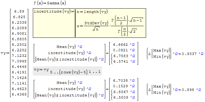

I've tried the plus-minus function, but can't get the min or max element values
Confirmed 10 x more accurate
In Process Control Instrumentation we calibrate
pressure XTR's from Secondary Standard Wallace Tiernam
We have two WT ... alternate calibrate to Ottawa Primary Standard
Your ± exposed in the attached.
Cheers ... Jean.
Stat Incertitude.sm (21.35 KiB) downloaded 1583 time(s).

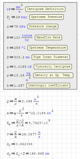

In that example of 100's Orifice Plate, all process data
are given by the Chemical Engineering team in Engineering Units.
The Consulting Instrumentation Engineer do two things:
1. best find "ΔP[Pa] ... User XTR" to minimize the models XTR's.
2. calculate the the bore diameter for all 100's plate.
On the turnkey day of the multi billions $ Plant, SI is not invited.

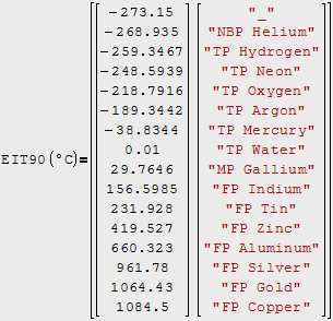

EIT90 fixed points [EIT = Echelle Internationale de Temperature].
Because they have an incompetent engineer who doesn't know how to work with units.
And there are trillion dollars of work done with using SI units, which sane persons do.
Instead of using SI units, Jean uses stupid coefficients (0.3537, 3.9989, etc).
Funny part is there are SI units everywhere on that example. (kg, °C, bar, Pa, mm)
Using unnecessary numbers doesn't eliminate them actually.
You are just holding your left ear with your right hand.
Look the example below Jean. It is much more readable, deprived of unnecessary convert numbers.
And more flexible too. I can use psi for pressure, easily change diameter to inch, revise temperature to K effortlessly.
Actually V in your example is indeed m/s, you just don't know that you don't know.
Some can make beta calculation with using units also. I just don't have the willpower.
