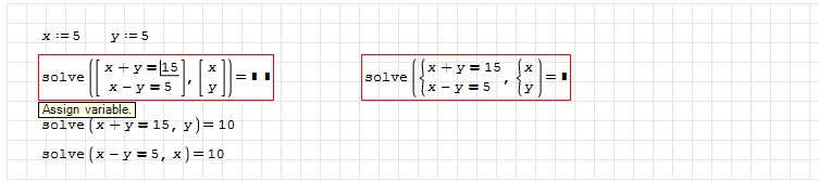

something is going wrong, but what?
I tried to solve two equations (x+y = 15 and x-y = 5), but the solver means "Assign variable" ???
If I do the same with just one exuation, it works?
(I'm new with Smath and just want to evaluate If we should use SMath or Mathcad Prime instead of Matcad 15 in future)

roots() is the appropriate command to solve this system
Thanks very much!
But why?

Different commands with different purpose, I guess.
Solve will work in finding multiple roots for one function, roots will find the "roots" of a non-linear system.
Developers may explain in depth why different commands for differents purpose have been implemented.

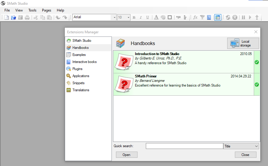

By the way, since you are approaching now SMath you may find useful to read a couple of "handbooks" prepared by some PRO users .
Some are available through the extension manager (Tools->Snippet Manager).
Among the ones available, I remember I read the two that I am highlighting in the image.
If you want to download this two (or even any other handbook), select "online gallery" instead of "local storage", and you will see the complete list.

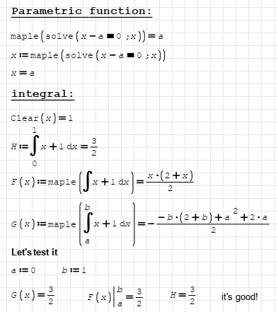

I am big fan of Solve() by the Maxima plugin and recommend it. With Solve() you can symbolically solve system of non linear equation without the need of defining before hands all the parameters: for example if you want to solve a parametric function like "x+a=0", Solve() will return a solution "x=-a" even if "a" is not defined, wherever solve() will complain about "a" not being defined.
My understanding is that native SMath Studio is optimized to solve stuff numerically, like a spreadsheet. If you want to be more abstract, then you need to use appropriate plugins. For example you can solve only defined integrals with native SS, where with Maxima Plugin you extend SS to handle also indefinite integral
solve_vs_maxima.sm (12.75 KiB) downloaded 651 time(s).
