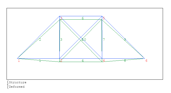

FEMTruss.sm (49.06 KiB) downloaded 886 time(s).
#4 Posted: 2017/9/11 00:46:07
Ernesto
Ernesto
13 likes in 74 posts.
So far results look good. Great work!
