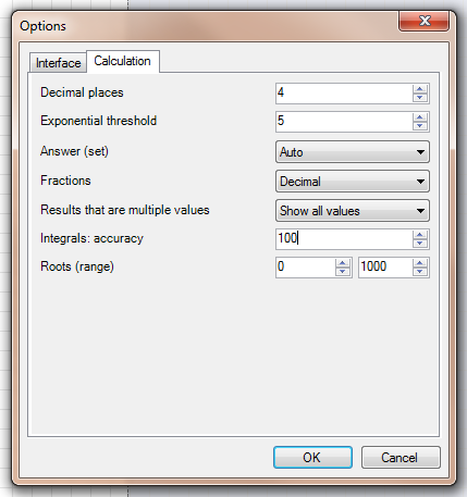

Probably you have an high range in your settings (try Tools -> Calculation -> Roots (range))
I get your result with -1000 .. 1000
Simply use a smaller or better range (f.e. in your example you can set the bottom range to 0)
![2014-11-21 23_24_11-SMath Studio Desktop - [WriterRegion.sm_].png](/zh-Hans-CN/files/Download/PsDsnm/2014-11-21-23_24_11-SMath-Studio-Desktop---[WriterRegion.sm_].png)
:d Thanx
That solved my problem - I set the roots (range) to -500;500 and the result is now right.
