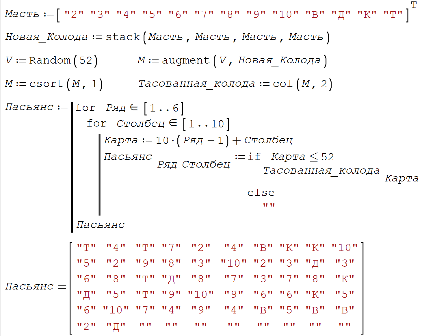

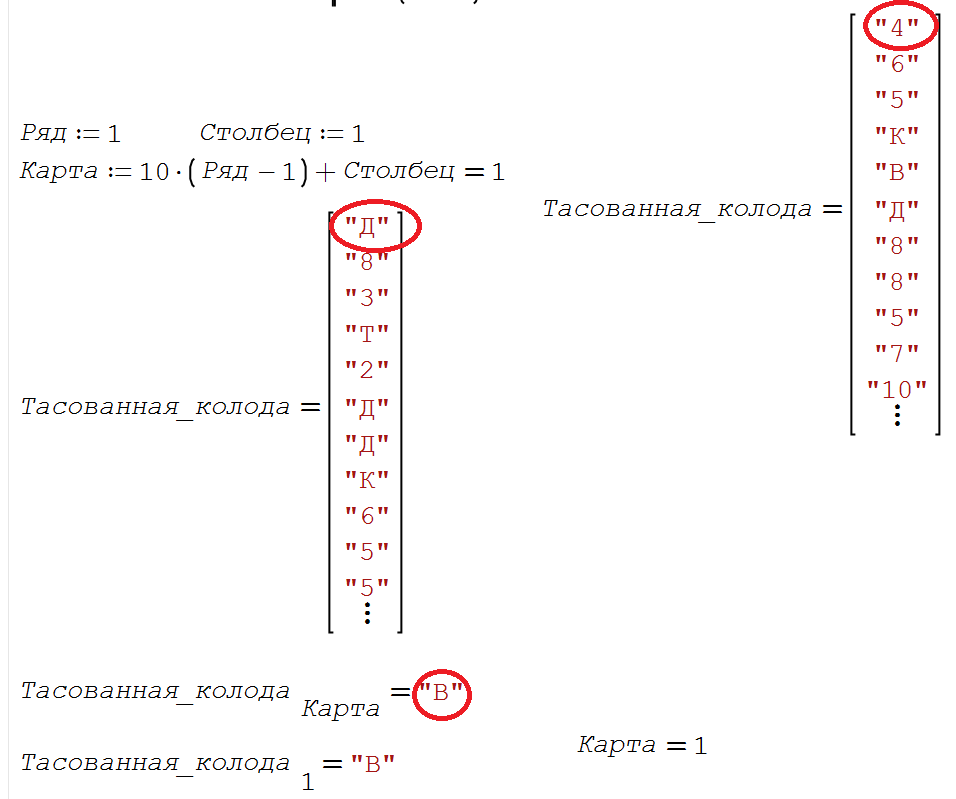

It is one strange bug, I think.
Without the program - all ok!
Patience.sm (37.01 KiB) downloaded 1363 time(s).

I wasn't able to reproduce the error, but it appears as if the Random() function is somehow redefining your variable every time you call "Тасованная_колода" to display.
