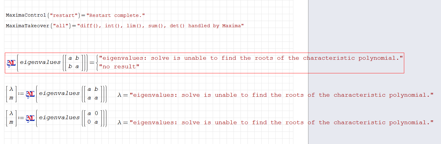

i'm studying SMath with Maxima (written by Dr. Kraska)
but i did not get the result.
my result is this.
smath with maxima.sm (94.66 KiB) downloaded 801 time(s).
thank you in advance

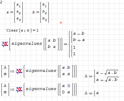

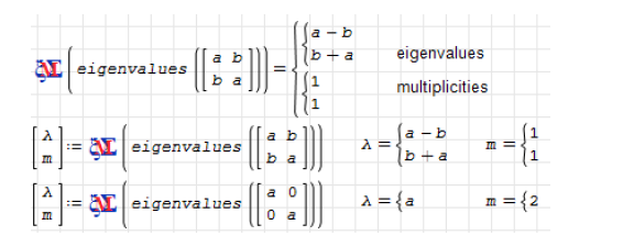

You have to clear the values of a and b. These must be scalar variables, in your sheet these are vectors.
