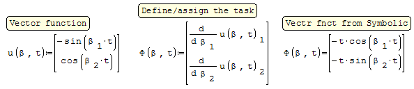

#4 Posted: 2018/2/16 11:21:08
Hej i want to differentiate a unit vector like
This is NOT unit vector. My understanding is that you want
a general procedure to differentiate a function vector.
This simple demo procedure is the core algorithm in Smath fitting functions
1. Genfit ,,,, 2. linfiCheby

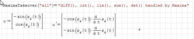

Here is another one. Maxima has generic vector-/matrix handling
diffm.sm (3.68 KiB) downloaded 714 time(s).
