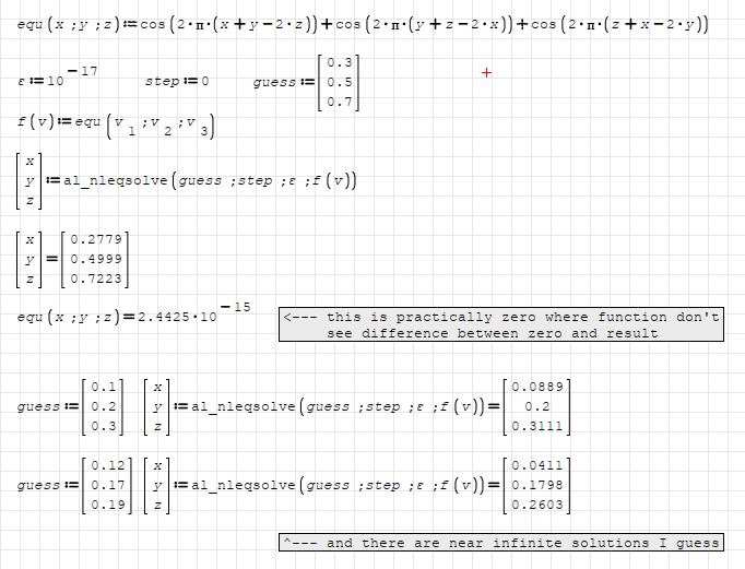

More experienced users may help you better than me.
But your equation seems to have infinite solutions.
al_nleqsolve equ(x,y,z).sm (10.75 KiB) downloaded 1015 time(s).
