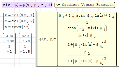

4. Max/Min value in matrix/vector
5. max/min of vector function(s) [example attached]

#4 Posted: 2018/6/22 00:00:42
Cursor needs to work like mathcad
Do you have that in Mathcad ... hover the pointer on the function.
#5 Posted: 2018/6/22 00:03:50
... forgot to attach the document.
Genfit [HV_WEZ].sm (39.66 KiB) downloaded 1326 time(s).

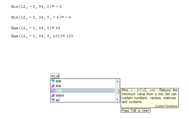

Need to be able to open/convert MathCAD Prime files
Mathcad Prime != MathCAD != SMath. If I recall correctly PTC didn't even have a great way to convert between MathCAD and MathCAD Prime. I know there existed a converter tool, but I had sporadic luck with it. This really isn't feasible between SMath and Mathcad or SMath and Mathcad prime. It best to manually convert.
Min() and max() functions ought be overloaded to also accept multiple arguments (same functionality as Mathcad). Or provide an easy way to convert the old mathcad files.
If you install the custom functions plugin, it includes functions that do this.

Example of Min/Max functions:
