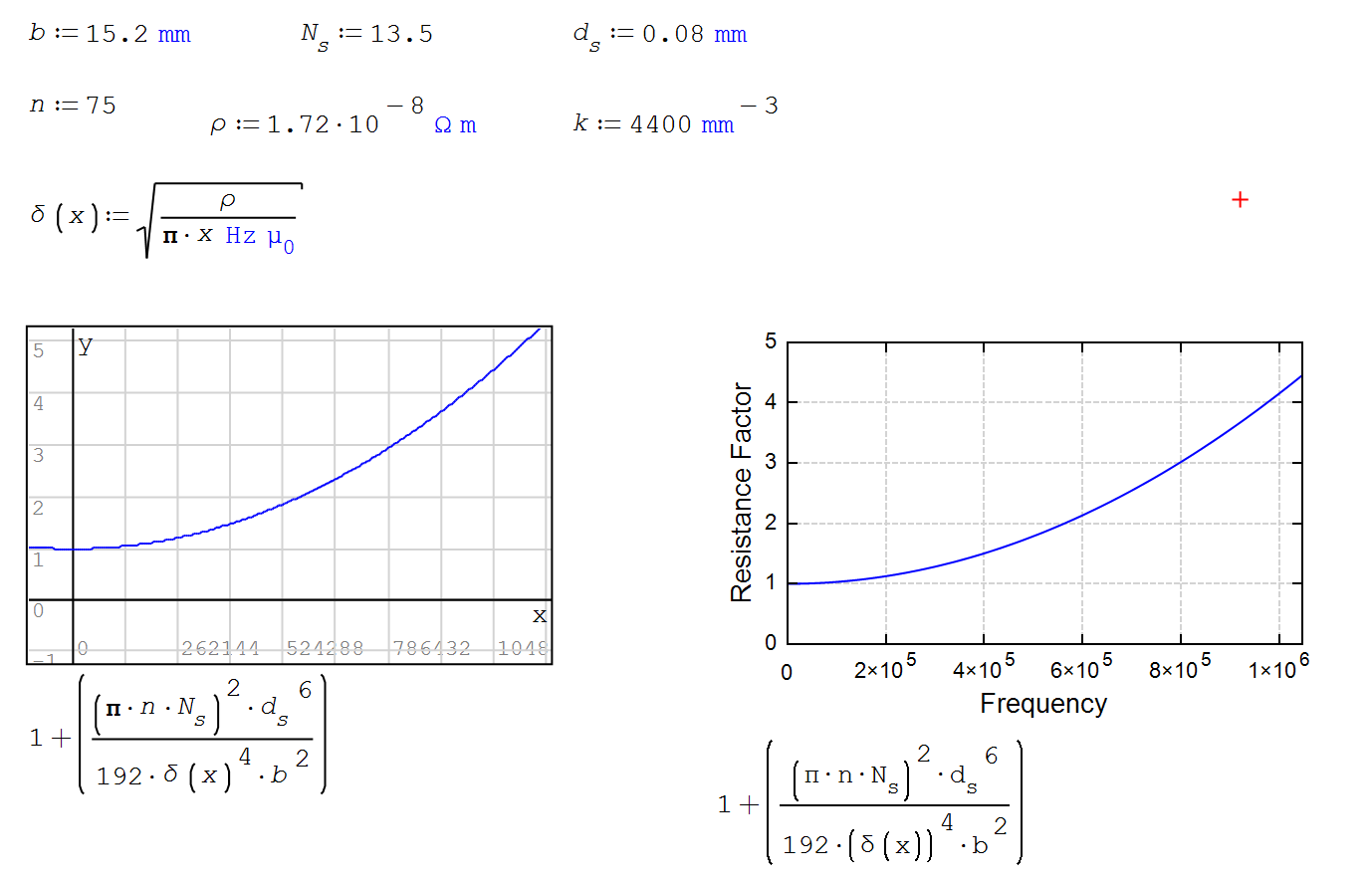

Hello, I'm lacking math skills and hoping someone can give guidance to create an X-Y plot with frequency on the X axis and resistance factor on the Y axis.
All parameters can be considered constant besides frequency in this example.
Thank you!

You only must define "f" as your variable "x" and plot
