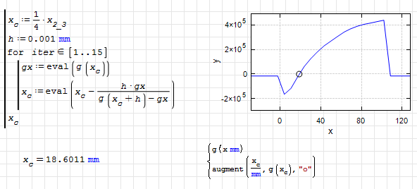

Hi Ale. Don't worry, your worksheet is well composed. Unfortunately SMath does not have simple functions to find roots by purely numerical procedures, and for some reason I cannot implement al_nleqsol, but you can always resort to the basic algorithms.

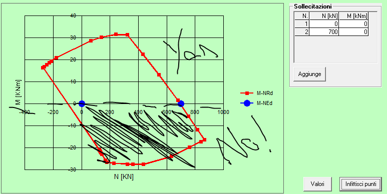

I'd like to see the M-N domain that should have this form (just the upper part of the of the domain show in the picture "Gelfi Domani").

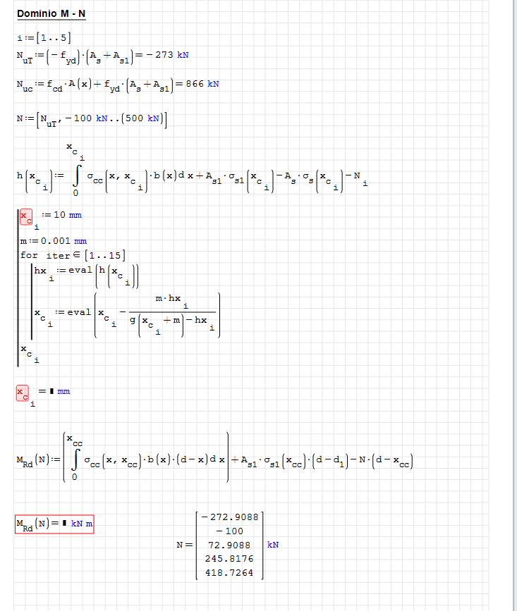

My problem is that I'm not able to find the solution for more than one N. I tried several stuff and ideas but I didn't find the correct way.
Someone has got the solution to find the neutral axis xi related to a range of Axial forces N (pic. "Neutral axis for multiple N")?

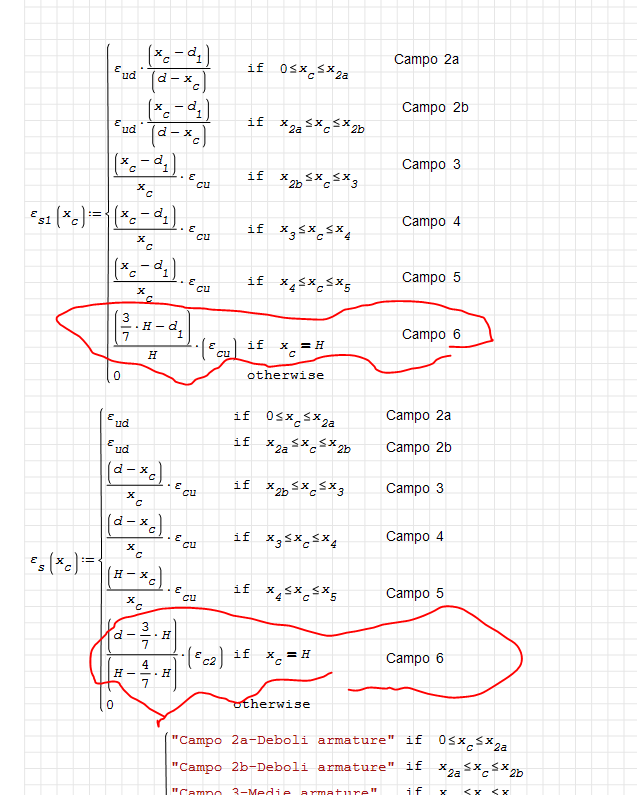

Additionally the domain is not complete in the last part, close to field 6 where the reinforced concrete sections are very brittle and totally compressed (pic "Assumption 1 and 2"), and where collaps happend for concrete failure.
Im pretty sure to have defined correctly the assumption until fild 5 in order to define concrete stresses and steel bars stresses, but the last part is surely wrong.
Someone know how to find the solution to that problem?

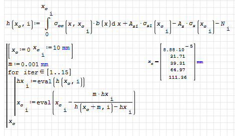

Hi. For the first question, this is a way to define a family of functions h(x) for a parameter i that can be manipulated later.

For the second question, from the point of view of numerical calculation, equalities do not exist, so it is very difficult to decide when x = H, since what can actually be detected is x-ε < H < x+ε or x ≈ H with the new operator '≈'. But then you also have to verify that other operations, such as the integral, detect that value. A generic way to do it is with the Dirac delta, but the drawback is that it is not a function, but a distribution, and it is not easy to implement it.
In other words, you have to implement a numerical model and verify that you get the desired values, or use other software, like Maple and the piecewise function, for example.
