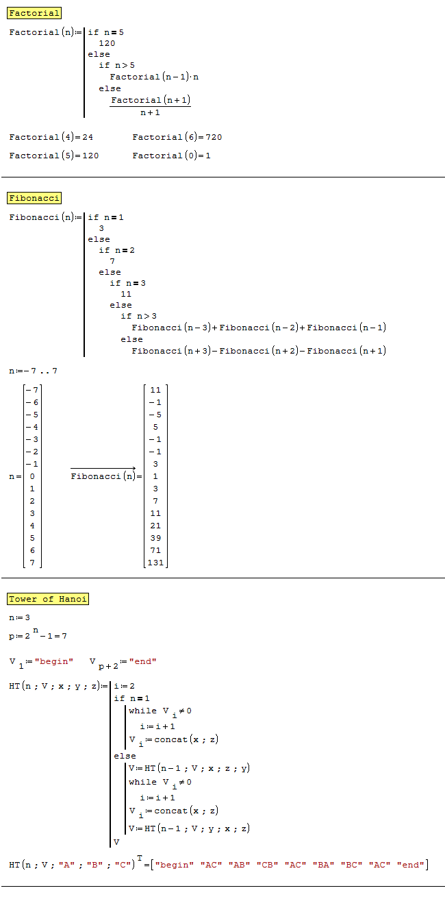

Three simple examples of recursion usage taken from this document: http://twt.mpei.ac.ru/ochkov/Recursion.pdf (created by V.F. Ochkov).
recursionExamples.sm (16.36 KiB) downloaded 1318 time(s).
Alexander O. Melnik 2016/3/29 13:45:00, Davide Carpi 2016/3/29 18:13:00
#2 Posted: 2016/3/29 13:09:10
2,340 likes in 4,041 posts.
Regarding 3-rd example: solution can be tested here: http://www.softschools.com/games/logic_games/tower_of_hanoi/

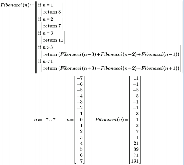

Regarding 2-nd example: as I mentioned, I took this example from the document, created by V.Ochkov. But I did a significant change against to the source - I've used vectorize function. Please see screenshot from referenced PDF:
What I don't understand, is why Mathcad gives correct result after call Fibonacci function with vector passed as an argument? How it determines that user wants this function to be called for every single vector element? Miracle!
Davide Carpi 2016/3/29 18:14:00
It is not a miracle. If you use an interval variable in Mathcad (n in this example is an interval variable - not a vector) then if you use a function and pass that interval variable to it, you will have the result of every element in that interval variable (Fibonacci(n)= ). There is a restriction here though. You can call that function, but you can not assign its result to a variable.
P.S. V.Ochkov is one of the person who knows quite a lot about Mathcad and Mathcad Prime
Andrey Ivashov 2016/3/29 14:08:00, Davide Carpi 2016/3/29 18:13:00

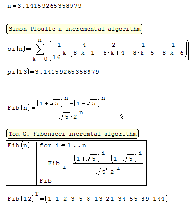

Fibonacci has a non-recursive form, something like pi from Simon Plouffe.
Pi [Simon Plouffe].sm (7.9 KiB) downloaded 1087 time(s).
