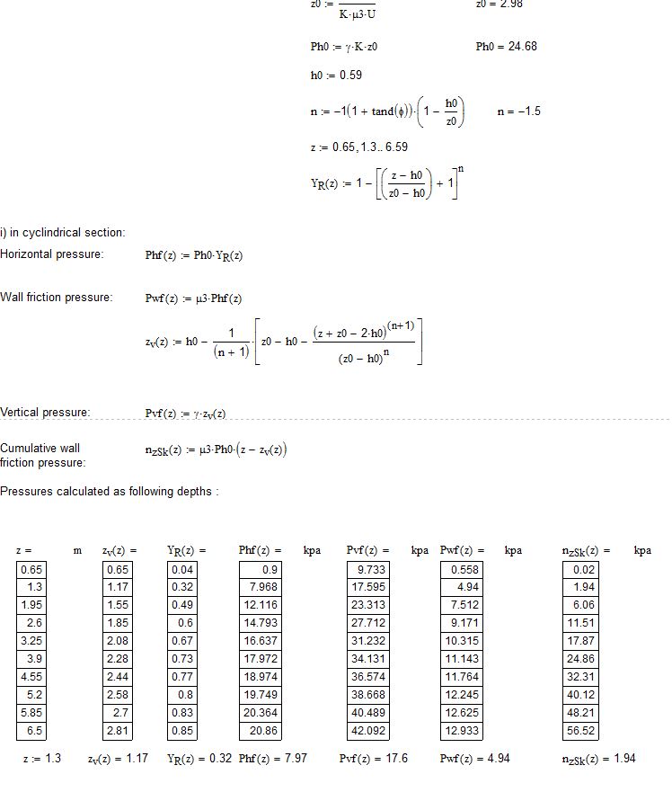

I realized that after sending the previous post, if an equation is dependant to a variable "z" you should set "z" after all dependant equations. But it can't be everytime because the results should be seen in the seperate parts. For instance I have filling and discharge pressures and the results should be printed in their relevant section. So I need to define a "z" before discharge pressures equations are created.
This way it is not possible to continue with the structure. Because I need to set "z" for a certain place and then I need another equation that depends on the "z" again.
So the storing of the variable which is a great feature according to you is not good for me unfortunately.
How can I change all the equations to like "Y.R(z)=..."? Because I have started to create a sheet with this manner but after a while it gave an error again.

Let's try to do it together. You do it up to the point where you have problems; you mark them and comment in the sheet and upload here, and I'll try to help you on the case-to-case basis. Does that sound sensible?
I must say that I live in Khabarovsk - Russian Far East, UTC+10. So, the timezone differences won't let us have immediate conversation, please excuse for that.
Please you excuse me. It is a help from you, not an obligation and you show kindness. I thank you for your idea and efforts. I will do and upload it here.

There is no more red in the attached.
Corrections in yellow.
There was/there is shadow in the project context
en 1991-4 jmG.sm (688.51 KiB) downloaded 1107 time(s).

Two things are critically missing:
1. The general drawing of the silo.
2. The Standard it is sourced from.
Hello mikekaganski,
I have managed out to create it with (z) function. You could see it attached. But how can I eliminate vectorize function to be added this formulas? Some of them is not working if I don't use vectorize.
en 1991-4 (z).sm (603.38 KiB) downloaded 1080 time(s).

I am creating this file from scratch and it is the first time I am using SMath. So I have to complete all the equations and variables and definitions. Then I will decorate the sheet with what it needs (silo sketch, codes used, header and footer (actually I need help for print settings), etc.). It is a time consuming process as I used mathcad for this type of calculations before. If you have sample calculation report for a steel silo or another structure created by SMath, it would be very helpful for me.
For the other replies from you: I started to use the variables with their unit. When I get the result by entering variable "z" SMath is creating a unit by itself. Then I change it manually because I know what it should be. The beauty is that, if I enter wrong unit for the result, SMath adds a unit to make it correct, then I can understand if there was a mistake. This feature is great.
You have created new variables "a" for z-ho/zo-ho but it should't be needed to calculate I guess. I attached the mathcad version of that part here and as you can see there is no separation needed for the formulas. In addition it is working even the "z" has been determined before the formulas created.
I see that you've overcome the difficulties, and managed to make your file working as expected. That's great! It's sad that you'd felt exhausted on the route, but the achievement should soothe that.
Actually, I don't understand your desire to eliminate vectorize(). I find that function very useful. I like to re-implement many old my functions that were made in pre-vectorize() era, with that function, and to get compact and clear implementations.
However, if you wish, tell me which one do you want to start with, and we'll try to see if eliminating vectorize() would be advantageous.
С уважением, Михаил Каганский
Thank you,
I don't want to use this function ever. As you could see for mathcad I don't need to remember to add vectorize function to solve the equations.
I'm afraid, that this is not exactly what you want, but to make some things clear.
