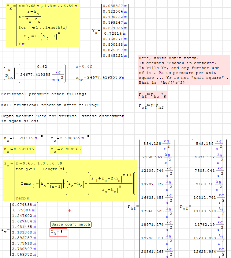

#26 Posted: 8/31/2016 4:33:30 PM
There is no more red in the attached.
Corrections in yellow.
There was/there is shadow in the project context
en 1991-4 jmG.sm (688.51 KiB) downloaded 1248 time(s).

#28 Posted: 8/31/2016 9:27:02 PM
Thank you Jean for your considerations.
You don't confirm if it has doctored your Smath version !
#29 Posted: 8/31/2016 10:27:47 PM
Berk,
Two things are critically missing:
1. The general drawing of the silo.
2. The Standard it is sourced from.

'kg/{'m*'s^2} What is that in Smath ?
N = kg * m/s2
#32 Posted: 9/1/2016 2:48:03 AM
Mike Kaganski
Mike Kaganski
184 likes in 434 posts.
Berk,
please don't consider the posts about units mismatch. There is misunderstanding WRT units in general, and their handling in SMath.
'kg/{'m*'s^2}='Pa. That is algebraic decomposition of SI complex unit, and as the decomposition is purely mathematical, it doesn't necessarily has physical meaning.
Also, Pa is not pressure per unit square. Pa is a unit of pressure, and pressure itself is force per unit square, or energy per unit volume. Note that the same unit (and the same physical property: pressure) may be decomposed differently and ccorrectly even from physical PoV. The two decompositions (per area / per volume) are very useful in different applications: first one in construction to represent forces, second one in hydraulics to represent energy.
So, the decomposition you see in SMath is mathematical one to most simple SI units, and it is done inside the app without taking into accocunt physical meaning. But it is mathematically correct, and so compatible with correct usage of units.
С уважением, Михаил Каганский

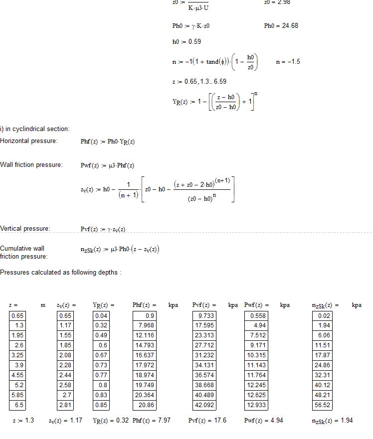

#33 Posted: 9/1/2016 4:46:16 AM
Berk Koç
Berk Koç
0 likes in 21 posts.
Let's try to do it together. You do it up to the point where you have problems; you mark them and comment in the sheet and upload here, and I'll try to help you on the case-to-case basis. Does that sound sensible?
I must say that I live in Khabarovsk - Russian Far East, UTC+10. So, the timezone differences won't let us have immediate conversation, please excuse for that.
Hello mikekaganski,
I have managed out to create it with (z) function. You could see it attached. But how can I eliminate vectorize function to be added this formulas? Some of them is not working if I don't use vectorize.
en 1991-4 (z).sm (603.38 KiB) downloaded 1211 time(s).

#35 Posted: 9/1/2016 8:36:24 AM
Mike Kaganski
Mike Kaganski
Hi Berk,
I see that you've overcome the difficulties, and managed to make your file working as expected. That's great! It's sad that you'd felt exhausted on the route, but the achievement should soothe that.
Actually, I don't understand your desire to eliminate vectorize(). I find that function very useful. I like to re-implement many old my functions that were made in pre-vectorize() era, with that function, and to get compact and clear implementations.
However, if you wish, tell me which one do you want to start with, and we'll try to see if eliminating vectorize() would be advantageous.
