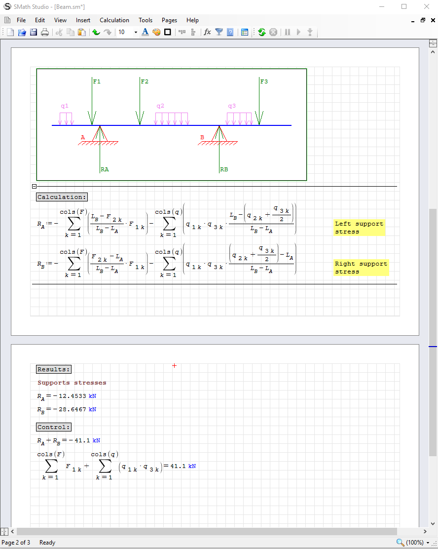

This release is prepared to demonstrate and test something new, which will be used by default soon.
Press Ctrl+Alt+L to activate.
This functionality is not completed yet (80% of work is done I would say), but already usable. For me, after the first minutes of work with pages view I absolutely don't want to work in legacy document view anymore. There are some observations related to zooming and printing using new visualization mode but I think these issues are minor.
Please let me know you any inconsistency found. Thanks in advance!

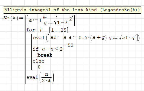

Discovered strange look of the for operator inside the function:
Wrote code outside, than copy-pasted it into the function.
Than it looks like that (look at Range2 inside for operator).
Andrey Ivashov 2018/1/30 16:10:00
Thank you! Fixed.
