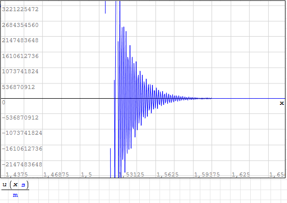

How can I plot the result as x(t) for t=0 to t=12 s ? From what I remember, plots require x as a variable so I tried with u(x) but I still can't make it work even with all the occurrences of t replaced with x (although I'd rather avoid doing that):
Operation units fixed with plot.sm (16.57 KiB) downloaded 1230 time(s).
#6 Posted: 2023/6/26 11:41:54
1,443 likes in 2,935 posts.
You have to manage the variable [x] and the result [f(x)] units
2023-06-26 16_39_37-SMath Solver - [Operation units fixed with plot.sm_].png
