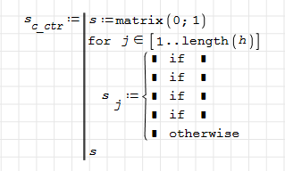

Definitions inside cases() arguments should be avoided.
WroteI have to point out once again that in general you shouldn't put definitions inside cases().
Unlike if(), when a condition or a case fails instead of throwing an error the whole function is returned like if doesn't exists. The consequence is that every argument is exposed and preprocessed, with potential unwanted behaviors respect to the expected logic. This is on the edge of SMath possibilities, but is what makes possible to use cases() whereas if() usually fails.
In your case it should look like in the screenshot below:
![2023-11-20 18_19_33-SMath Solver - [Worksheet1_].png](/zh-Hans-CN/files/Download/dKKmBv/2023-11-20-18_19_33-SMath-Solver---[Worksheet1_].png)
Notice that I initialize a local variable to avoid unintentional inheritance of existing vectors (if you call it twice and the second time h has less values than the first time, the second s.c_ctr will be the first vector with the initial values updated)

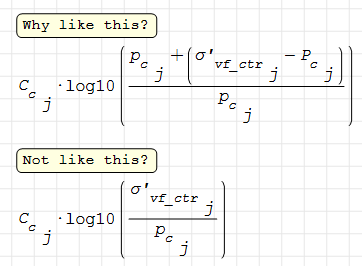

Since the first case catches all the conditions where OCR[j] <= 1, the 2nd and third "(OCR[j] > 1) AND" checks are redundant.
Also, since Sigma'vf_ctr[j] <= pc[j] case is captured in the second condition, the third case can be written in the otherwise placeholder.
This is also the reason why I try to code things as explicitly as possible (including in the if statements) so that the students can follow along easier.

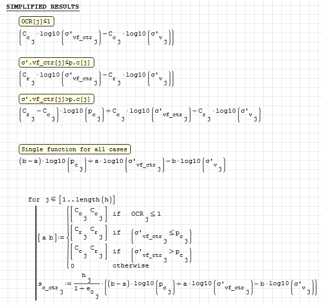

WroteThere is room for improvements in the conditions management.
If I didn't made a mistake, this is most simplified I could get.
Here is the file contains logarithmic simplification steps.
cases_simplified.sm (35.71 KiB) downloaded 829 time(s).
