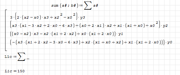

Hello Everybody,
Sometimes, I deal with formulas laying out in a very long line, as shown in the appended file examples.
Long Lines Formulas - Width Reduction.sm (72.77 KiB) downloaded 361 time(s).
To improve the use of such structures, I consider using a matrix presentation.
The sum of the matrix terms is equivalent to the input formula; see the checks in my examples.
Seeing the complex imbrication of the input formula’s terms, the “by hand organization” treatment is often fastidious and hard to prevent errors.
I imagine that many people had to face this problem of handling results from symbolic integration, for instance.
I noticed useful tools like “simplify,” “expand,” and “convert,” available with MAPLE. They are available also with Maxima.
I wonder if there is a way or a tool to deal with the problem in a more specific way?
Thanks for your attention and for your solutions.

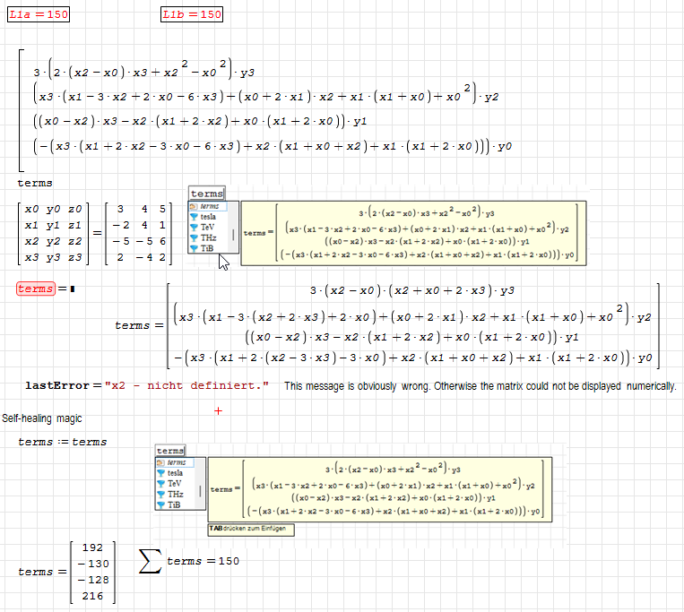

Here is a version with the Mathcad block.
Unfortunatly not without something strange happening in the background.

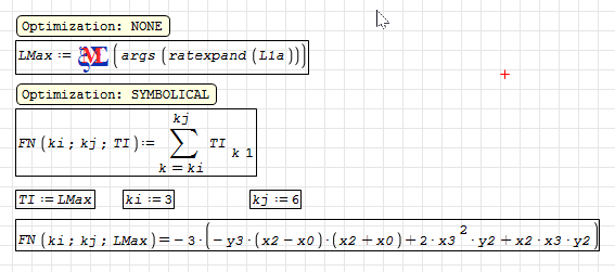

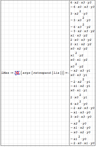

How about this one... use optimization/none
ioan92 2026/4/6 11:27:54
#7 Posted: 2026/4/6 12:56:35
ioan92
ioan92
180 likes in 120 posts.
Thanks a lot !!!
That's it what I need to build a "constructor" for the final result vector - split the line in simple terms.

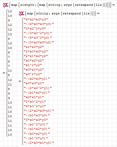

I still need a tool to count the number of charaters of a line of the final vector. Maibe is there something in the Davide's tresaury ?
#8 Posted: 2026/4/6 16:59:17
1,355 likes in 2,271 posts.
This is just native Maxima.
Edited 2026/4/6 17:00:14

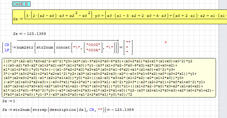

Hi. This could be another approach. For a long formula, where even separating terms can be tricky, simply take its string and add some carriage returns anywhere in the description (with shift+Enter) so it doesn't overflow the page. This works to show the formula being used, assuming whoever reviews it is a very meticulous and patient person.

I applied Martin's solution, based on Maxima, on a very long equation.
I obtained a matrix of matrices, equivalent to the initial one very long line equation .
As an example, I put the case in the appended file.
Split and Recoposition of a Line Equation.sm (320.98 KiB) downloaded 407 time(s).
The procedure could be general. I have not yet a definitive presentation of all necessary transformations
If somebody is interested in the subject, please send a sign,
Ioan
Hi Alvaro,
I’m, once again, impressed with the condensed formalism you deployed.
Your solution is very compact, but I hadn’t announced yet my “hidden” objective.
In fact, as long as I rest in the SMath environment, the equation length does not disturb me excessively. Also, as long as I’m into the SMath environment, the symbolic solution of integration is nice, compact and “efficient” (?). But, when I step out into a different programming environment, I feel it necessary to have an explicit solution! (???).
That’s why I enjoy Martin’s way – as fitting more my expectations.
All my thanks for your brilliant solution. I save it in my treasury.
Best regards,
Ioan
