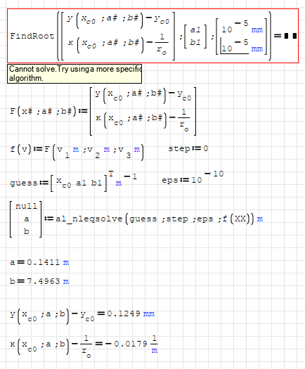

Can not solve a system of two equations
Can not solve a system of two equations - Help me please - Messages
#1 Posted: 2023/10/7 16:31:52

#2 Posted: 2023/10/8 08:58:36
roots supports a single argument
Valery Ochkov 2023/10/8 09:05:00
#3 Posted: 2023/10/8 09:04:57
#4 Posted: 2023/10/8 13:51:08
598 likes in 1,380 posts.
You don't have to eliminate units.
There are tricks to use them in solvers.
This is the best I could get.
Maybe a pro user can help you better.
roots() supports multiple argument btw.
Your equations has derivative.
Possibly reason of error by conventional solvers.
roots(), FindRoot(), solve() mostly doesn't like it.
CP-Cyrcle_solved.sm (32.37 KiB) downloaded 1247 time(s).

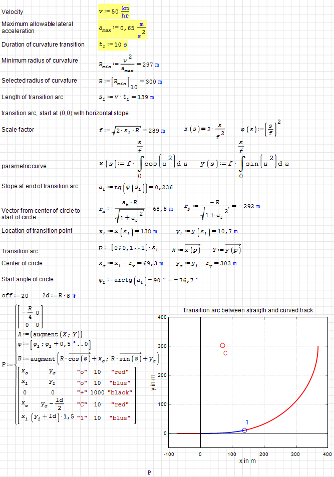

#5 Posted: 2023/10/9 05:44:58
1,355 likes in 2,271 posts.
This is a version without solving equations. The curvature is known as a function of the path length.
02 Ubergangsbogen.sm (80.24 KiB) downloaded 1309 time(s).
Valery Ochkov 2023/10/9 05:52:00, Oscar Campo 2023/10/9 07:39:00
