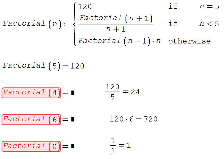

Factorial.sm (5.38 KiB) downloaded 1375 time(s).

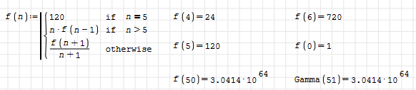

Hi Valery. Just use line:

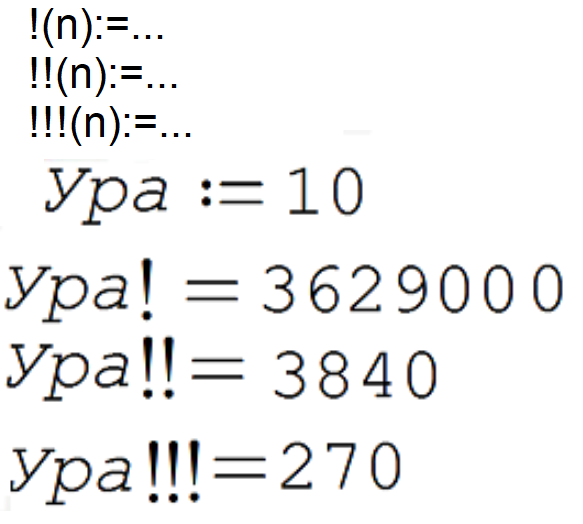

But I think about a postfix operator.

Oh. I see. What an epic fail trying to interpret an "it" (From "Create it in SMath! " ). I had seen that work at a Soviet art exhibition at the Museo de Bellas Artes in Mexico City, and it is without a doubt very representative of an entire movement.

https://en.smath.com/forum/yaf_postst25358_Pre--Post--and-Infix-Operators.aspx
