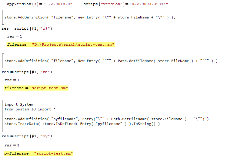

#43 Posted: 2024/11/24 00:21:40
1,554 likes in 1,864 posts.
As a temporary solution, I decided to add a function that can execute text scripts. Unfortunately, I can't build a working plugin on the server, so for now I'm just showing how it will work.
Oscar Campo 2024/11/24 16:48:00, Alvaro 2024/11/25 12:47:00
