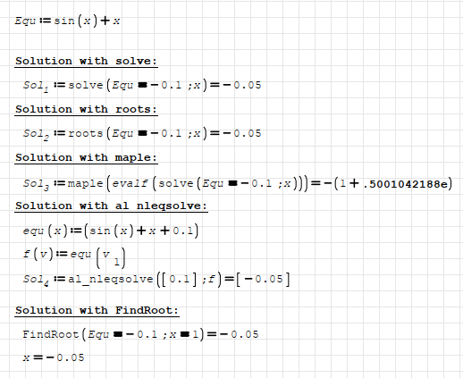

#2 Posted: 2022/4/29 06:19:37
1,554 likes in 1,864 posts.
Various examples are possible.
Mathcad Block. FindRoot example.sm (4.81 KiB) downloaded 1134 time(s).

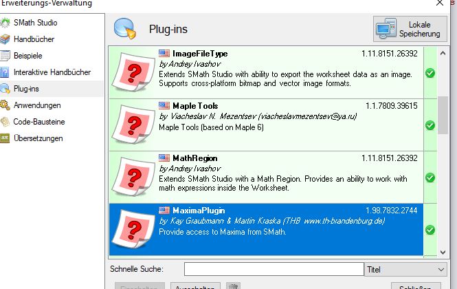

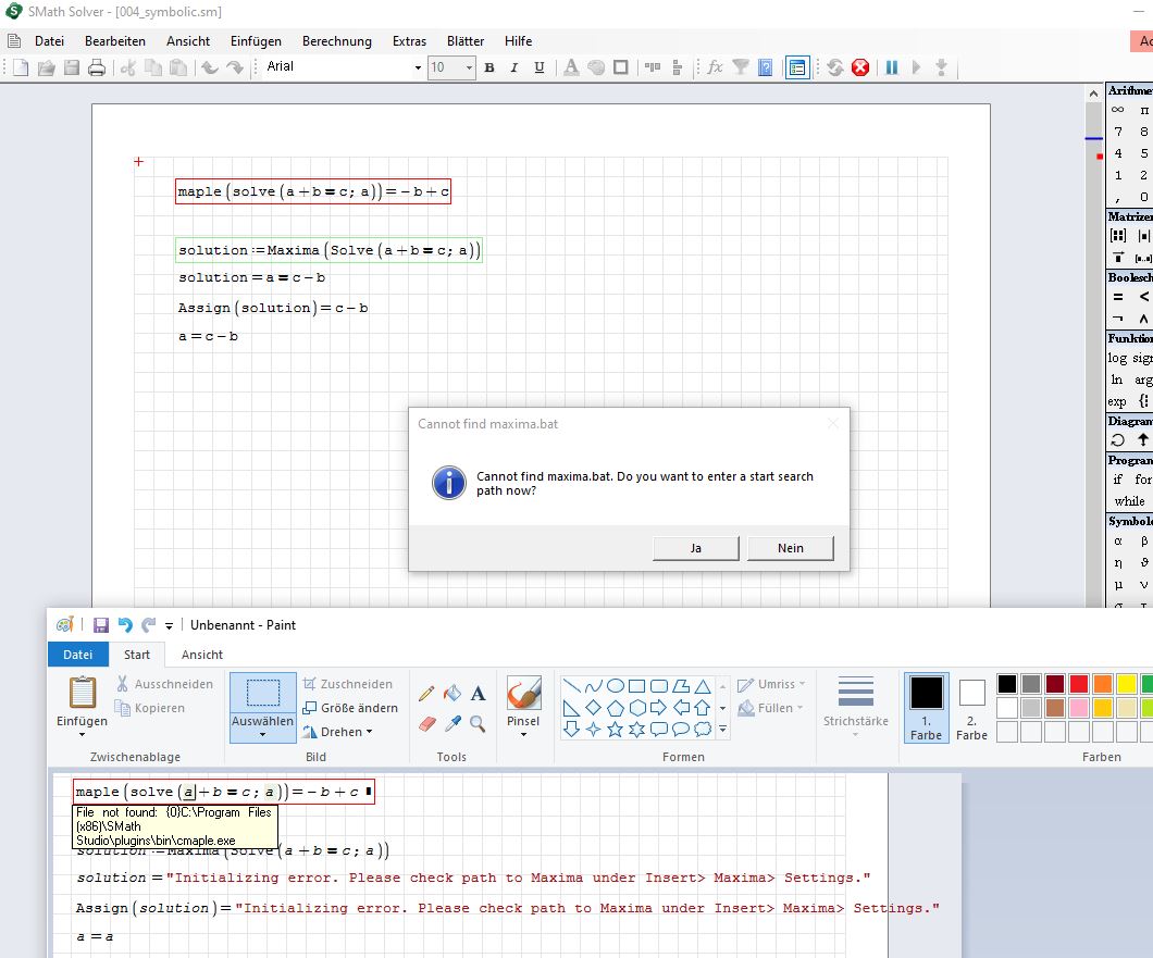

Thank you but i have a problem i downloaded the latest version
i downloaded maxima plugin and others but i do get a failure when opening your file see attached picture
There is a file missing:
cmaple.exe / maxima.bat missing
What can i do ?
however smath says maxima plugin is installed:
Thank you br Stefan
#14 Posted: 2022/5/4 06:42:10
598 likes in 1,380 posts.
What can i do ?
Thank you br Stefan
It seems your mentioned firewall settings prevented proper installation of Maple plugin.
Usually SMath plugins are saved under this path in Windows 10.
C:\Users\/AppData/Roaming/SMath/extensions/plugins/
I can copy my plugins directory on Windows partition and upload it for you to download and copy/overwrite.
But it won't be a convenient way to install plugins. Set an exception to your firewall for SMath downloads.
Maxima is another subject, plugin seems installed but you will need Maxima software to make it work.
Latest version can be downloaded and installed from link below.
https://netix.dl.sourceforge.net/project/maxima/Maxima-Windows/5.46.0-Windows/maxima-5.46.0-win64.exe
You also have to set the path for Maxima.bat under Insert>Maxima control windows>Settings menu.

#20 Posted: 2022/5/4 08:10:28
but i cannot find the plugin
software needs cmaple.exe in order to work. Where do i find this?
https://smath.info:8443/!/#public/view/head/plugins/MapleTools/Resources
It is in cmaple.zip file on this page.
It is in also plugin.zip file I uploaded for you.
